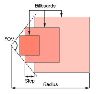

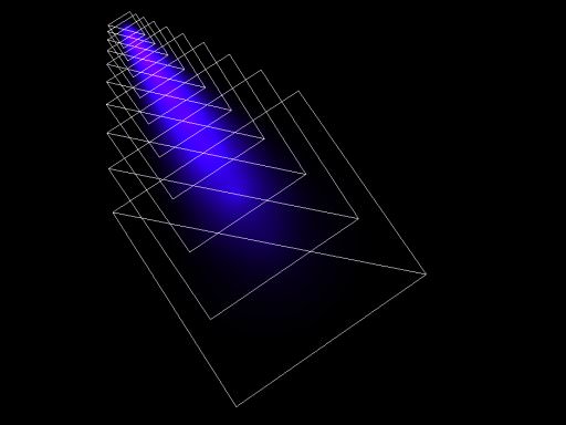

Volume Projected is rendered as a simple particle system. It is a number of Billboards, where each following Billboard is bigger than the previous one.
Billboards of a Volume Projected object

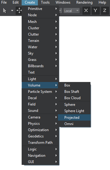

To create a Volume Projected object, perform the following steps:
  1. On the Menu bar, click Create -> Volume -> Projected.
  2. Place the Volume Projected object somewhere in the world.
  3. Specify the Volume Projected object parameters.

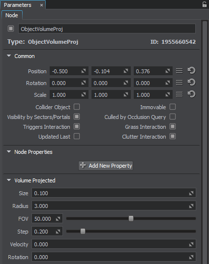

In the Volume Projected section (Parameters window -> Node tab), you can adjust the following parameters of the Volume Projected object:
Size Size of the smallest Billboard in units. By the minimum value of 0, Volume Projected is not rendered at all.
Radius Length of the light beam along the Z axis, in units.
FOV
Width of the light beam. It is specified as the angle of the beam cone (in degrees).
  • By the minimum value of 10, the beam is the narrowest.
  • By the maximum value of 90, the beam is the widest.
Step
Distance between neighboring Billboards.
  • The lower the step is, the smoother the beam, since more Billboards are rendered.
  • The higher the step, the more discrete the beam, but the higher the performance is.
Velocity Velocity with which Billboards move to the end of the beam (along the Z axis).
Rotation
Angle of Billboards rotation (in degrees). This angle is set for the Billboard at the end of the beam.
  • If positive, all Billboards rotate clockwise.
  • If negative, all Billboards rotate counterclockwise.
