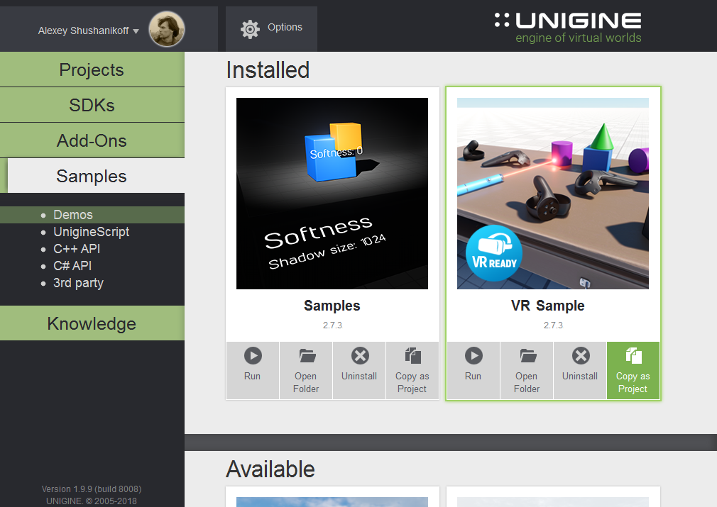

1. Making a Template Project#
So, ok we have a cool demo with some stuff inside, but how do we use it as a template? It's simple - just open your SDK Browser go to the Samples tab and select Demos.

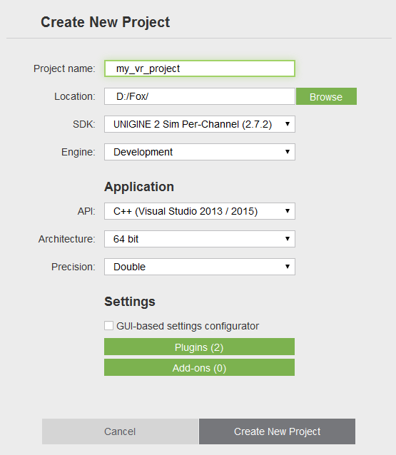

Find the VR Sample in the Available section and click Install. After installation the demo will appear in the Installed section, and you can click Copy as Project to create a project based on this sample.
In the Create New Project window, that opens, enter the name for your new VR project in the corresponding field and click Create New Project.

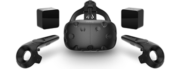

Suppose you have successfully installed your Head-Mounted Display (HMD) of choice (please visit Oculus Rift Setup or HTC Vive Setup in case you did not). In case you are having difficulties getting your HTC Vive to work, this Troubleshooting guide might be helpful.
Major VR devices are supported out-of-the-box so the only thing you should do is to make sure that the correct plugin is loaded for your HMD.
HTC Vive Oculus Rift
If you run the application via UNIGINE SDK Browser, set the Stereo 3D option to HTC Vive in the Options tab and click Apply:

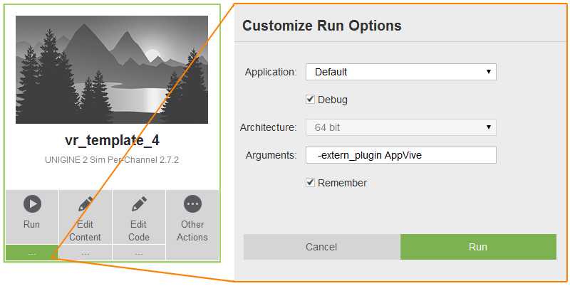

If you run the application via UNIGINE SDK Browser, set the Stereo 3D option to Oculus Rift in the Options tab and click Apply:
To launch the plugin, specify the extern_plugin command line option on the application start-up:
Shell commands
your_app_name -extern_plugin "AppOculus"
You can also specify the plugin to be loaded for your application via the Customize Run Options.

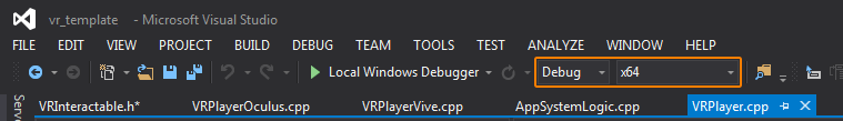

Don't forget to set the appropriate platform and configuration settings for your project before compiling your code in Visual Studio.
Now, we can try and build our application for the first time.
Build your application in Visual Studio (BUILD -> Build Solution) or otherwise, and launch it by selecting the project on the Projects tab of the UNIGINE SDK Browser and clicking Run.
Before running your application via the UNIGINE SDK Browser make sure, that appropriate Customize Run Options (Debug version and x64 architecture in our case) are selected, by clicking an ellipsis under the Run button.

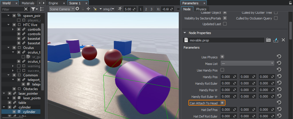

Sometimes it might be necessary to attach some object to the HMD to follow it (e.g. a hat). All movable objects (having the movable.prop property assigned) have a switch enabling this option.
For example, if you want to make a cylinder on the table attachable to the HMD, just select the corresponding node named "cylinder" in the World Hierarchy click Edit in the Reference section and enable the Can Attach to Head option.
Then select the parent node reference, and click Apply.

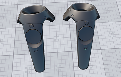

In your VR Application you might want to display hands instead of standard controllers included in the sample (e.g. for HTC Vive).
This is simple - just perform the following steps:

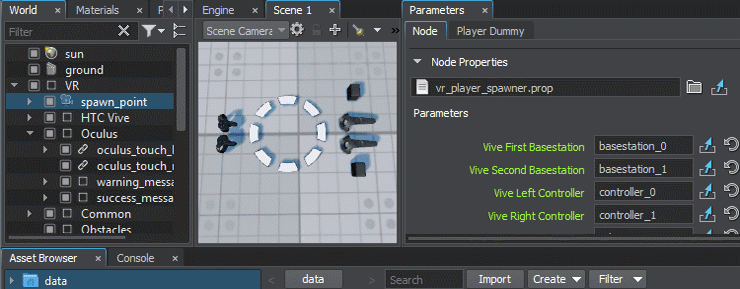

  1. Open the world in the UnigineEditor
  2. Select VR -> spawn_point (a Dummy Player node with the VRPlayerSpawner component) in the World Hierarchy window and go the the Node Properties section in the Parameters window.
    Basic VR Player settings (the look of controllers and teleport points, teleport ray color, hand force multiplier for physical interactions, spawn point location, etc.) can be customized via the VRPlayerSpawner component or the fields of corresponding vr_player_spawner.prop property.
  3. Drag the desired node for each hand from the World Hierarchy window or Scene Viewport to the corresponding field of the vr_player_spawner.prop property. For example, we can make Vive controllers look like Oculus Touch by dragging oculus_touch_left and oculus_touch_right nodes to Vive Left Controller and Vive Right Controller fields respectively.
  4. Save the world and launch your VR application, your Vive controllers will look like Oculus Touch in VR.

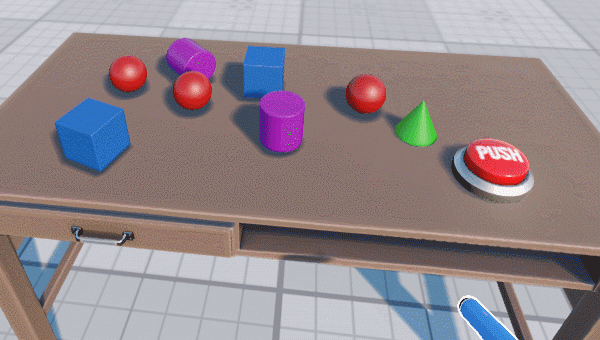

The next step in extending the functionality of our VR Sample is adding a new interactable object.
Let's add a new type of interactable object, that we can grab, hold and throw with an additional feature: object will change its form (to a certain preset) when we grab it, and restore it back, when we release it. It will also display certain text in the console, if the corresponding option is enabled.
So, we're going to use the following components:
  • ObjMovable - to enable basic grabbing and trowing functionality
  • new ObjTransformer component to enable form changing and log message printing functionality

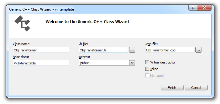

  1. Add a new ObjTransformer class inherited from the VRInteractable. In Visual Studio we can do it by choosing Project -> Add Class from the main menu, clicking Add, specifying class name and base class in the window that opens, and clicking Finish:
  2. Implement functionality of transformation to the specified node on grabbing, and restoring previous form on releasing a node
    Below you'll find header and implementation files for our new ObjTransformer class:

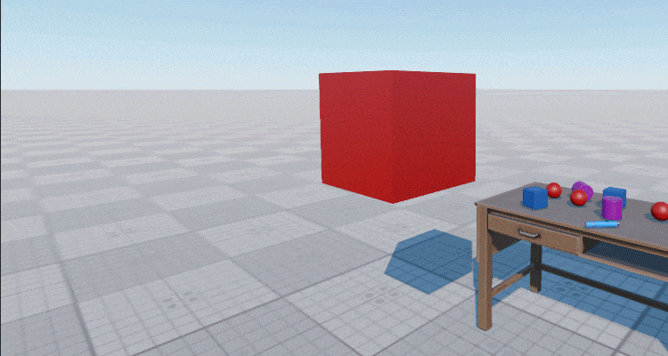

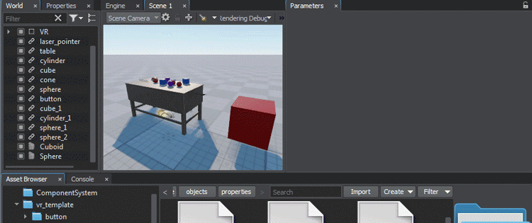

  3. Build your application and launch it as we did earlier, a new property file (transformer.prop) will be generated for our new component.
  4. Open the world in the UnigineEditor, create a new box primitive (Create -> Primitive -> Box), and place it somwhere near the table, create a sphere primitive (Create -> Primitive -> Box) to be used for transformation.
  5. To add components to the box object select it and click Add New Property in the Node Properties section, then drag the movable.prop property to the new empty field that appears. Repeat the same for the transformer.prop property, and drag the sphere from the World Hierarchy window to the Target Object field.
  6. Save your world and close the UnigineEditor.
  7. Launch your application.
