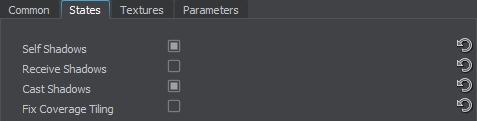

The clouds_base material has the following states:
Material Editor, States tab.
Self Shadows | This state determines if a cloud layer casts shadows on itself. By default the state is enabled.
Receive Shadows | This state determines if shadows from an upper cloud layer can be cast on this cloud layer. By default the state is disabled.
Cast Shadows | This state determines if a cloud layer casts shadows. By default the state is enabled.
Fix Coverage Tiling | This state determines if reduction of tiling for the clouds coverage texture is enabled. Such tiling becomes noticeable in large-scale worlds when observing clouds at significant distances. It is recommended to enable this state only when the unwanted effect appears. Please use it wisely, as additional texture fetching affects performance. By default the state is disabled. Notice
Tiling reduction for clouds should be enabled globally (via Settings -> Rendering -> Clouds -> Fix Tiling). |

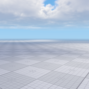

Layer Height | Determines the height of the cloud layer.
Coverage Size | Determines the size of the coverage texture.
Coverage Contrast | This parameter determines the contrast of the coverage texture and can be used for fine tuning. It also makes it possible to gradually increase cloudiness without changing the coverage texture when simulating weather. The lower the value the more cloudy the sky looks.
For this parameter to work properly, the coverage texture must not contain absolutely black pixels.
Coverage Cloudiness | Intensity of storm clouds coverage that is stored in the Green channel of the Clouds coverage texture.
Bottom Fade | Determines the form of clouds bottom. Lower values make the bottom more flat.

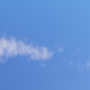

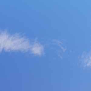

Cloud Density | Controls density of the clouds which determines visual appearance. This parameter can be used to simulate cirrus clouds. The default value is 1.
This parameter should only be used when the desired visual appearance cannot be achieved using other parameters. The higher is the cloud density, the higher is the performance. Lower density values can significally reduce performance.

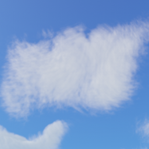

Detail Noise Size | Determines the size of details cutout from the clouds. This parameter is analogous to the Noise size parameter. The lower is the value the larger pieces are cutout.
Detail Distortion Size | Determines the scale of clouds detail distortion according to the corresponding texture. This parameter is used to control detail turbulence. The higher is the value the stronger is the detail turbulence effect.
Detail Distortion Force | Determines the intensity of clouds detail distortion. This parameter is used to control detail turbulence. The higher is the value the stronger is the detail turbulence effect.
Detail Intensity | Adjusts detail cutout intensity. Details are cut mostly from the bottom of the clouds. Notice
Thunderclouds are dense and do not have detail cutout. Therefore, they have detail intensity value equal to 0.
