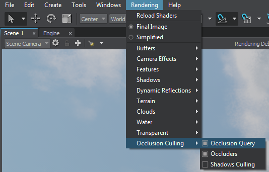

- Rendering of occluders is enabled: in the Menu Bar, Rendering -> Occlusion Culling -> Occluders is toggled on.启用遮挡物渲染:在菜单栏中,启用了Rendering -> Occlusion Culling -> Occluders。
- Rendering of shadows from the occluded objects is disabled: in the Menu Bar, choose Windows -> Settings -> Occlusion Culling and toggle Shadows Culling on.
注意You can leave shadows rendering enabled, if necessary.禁用了遮挡对象的阴影渲染:在菜单栏中,选择Windows -> Settings -> Occlusion Culling并启用Shadows Culling。You can leave shadows rendering enabled, if necessary.You can leave shadows rendering enabled, if necessary.注意You can leave shadows rendering enabled, if necessary.如有必要,可以启用阴影渲染。

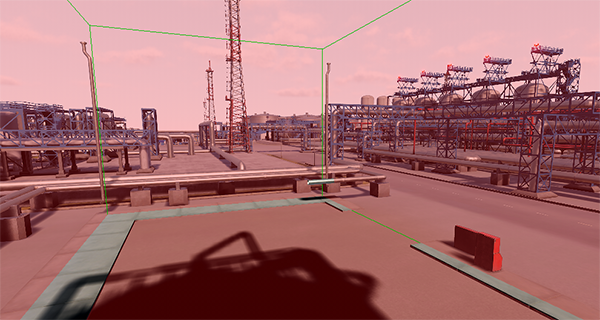

Using a Box-Shaped Occluder使用盒形封堵器#

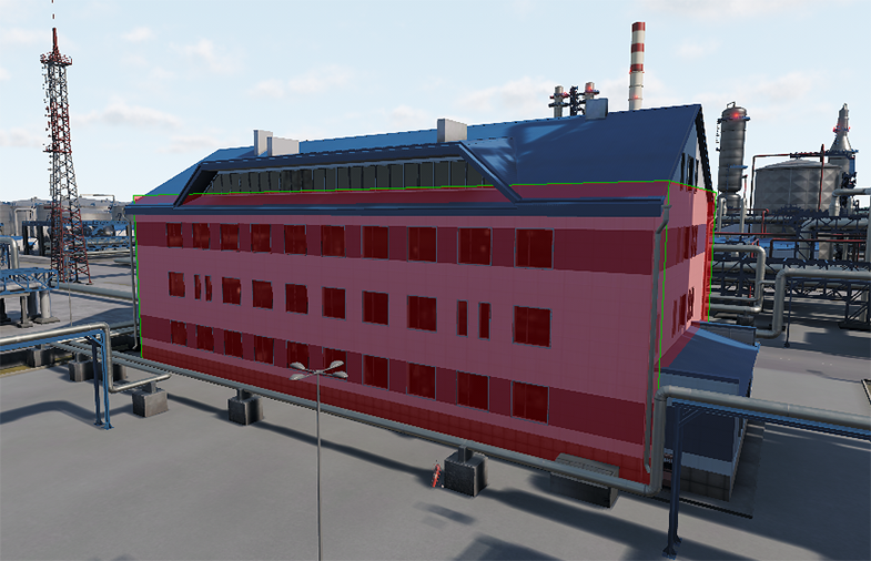

The occluder is a box shape that culls objects' surfaces, bounds of which aren't visible behind it. This is the simplest type of occluders that should be used together with box-shaped objects that block off other objects. For example, you can add an occluder the shape of which coincides with the bounds of a building to avoid rendering of objects behind this building. occluder是一个框形形状,用于剔除对象的表面,其后部的边界不可见。这是最简单的封堵器,应与阻挡其他物体的箱形物体一起使用。例如,您可以添加一个遮挡物,遮挡物的形状与建筑物的边界重合,以避免在该建筑物后面渲染对象。
To create a box-shaped occluder, perform the following:要创建盒形封堵器,请执行以下操作:

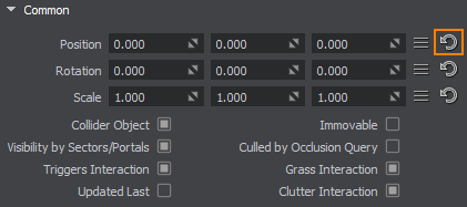

- In the Menu Bar, choose Create -> Optimization -> Occluder and add the occluder as a child to the node that should occlude other objects.在菜单栏中,选择Create -> Optimization -> Occluder并将遮挡物作为子项添加到应该遮挡其他对象的节点上。

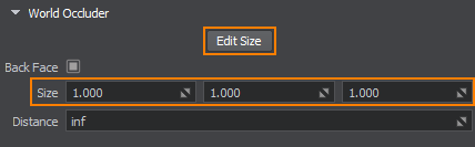

- In the Common section of the Node tab in the Parameters window, set the position of the occluder to the parent one.
在Parameters窗口的Node选项卡的Common部分中,将遮挡物的位置设置为父遮挡物的位置。 - In the World Occluder section of the Node tab, click Edit Size to enable the editing mode for the occluder. Resize the occluder by using the colored rectangles on the occluder box sides so that it coincides with the parent node size.

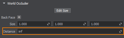

You can also use the Size parameter to set the size along the axes.在Node选项卡的World Occluder部分中,单击Edit Size以启用封堵器的编辑模式。通过使用阻塞器框两侧的彩色矩形来调整阻塞器的大小,使其与父节点大小一致。 - Specify the Distance between the camera and the occluder, at which the occluder doesn't occlude anything and, therefore, should be disabled to avoid negative impact on the performance.
在摄像机和遮挡件之间指定Distance,在该位置遮挡件不会遮挡任何东西,因此应将其禁用以避免对性能造成负面影响。
To check how the occluder works, disable the parent node and then try to toggle the occluder on and off:要检查阻塞器如何工作,请禁用父节点,然后尝试打开和关闭阻塞器。

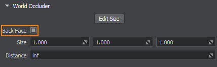

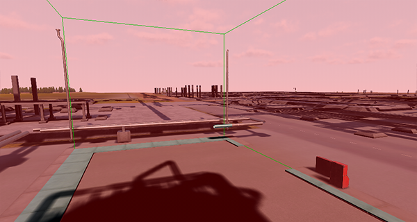

By default, the front faces of the occluder are used to cull objects. However, if the camera is inside the occluder (e.g. inside the building), occlusion culling won't be performed. To avoid such situation, enable the Back Face parameter in the World Occluder section of the Node tab. 默认情况下,封堵器的正面用于剔除对象。但是,如果摄像机位于遮挡物内部(例如建筑物内部),则不会执行遮挡剔除。为避免这种情况,请在NodeBack Face选项卡的World Occluder部分中启用参数。

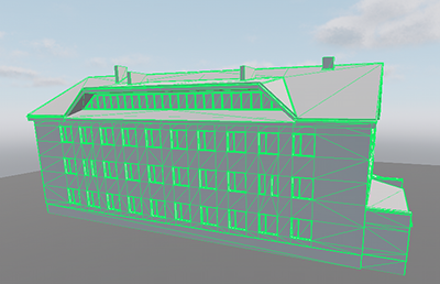

Using a Mesh-Based Occluder使用基于网格的遮挡物#

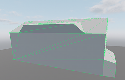

The occluder mesh is based on an arbitrary mesh that culls objects' surfaces, bounds of which aren't visible behind it. The occluder mesh is used together with the geometry that cannot be approximated with a box. occluder网格 是基于任意网格的,该网格对对象的表面进行剔除,其边界在后面不可见它。封堵器网格与无法用框近似的几何一起使用。
To create a mesh-based occluder, perform the following:
- Prepare a low-poly mesh to be used for the occluder.
注意It isn't recommended to use the same detailed mesh that is used for the node that should occlude other objects: the mesh for the occluder should be as simple as possible to avoid performance loss.Prepare a low-poly mesh to be used for the occluder.It isn't recommended to use the same detailed mesh that is used for the node that should occlude other objects: the mesh for the occluder should be as simple as possible to avoid performance loss.It isn't recommended to use the same detailed mesh that is used for the node that should occlude other objects: the mesh for the occluder should be as simple as possible to avoid performance loss.注意It isn't recommended to use the same detailed mesh that is used for the node that should occlude other objects: the mesh for the occluder should be as simple as possible to avoid performance loss.It isn't recommended to use the same detailed mesh that is used for the node that should occlude other objects: the mesh for the occluder should be as simple as possible to avoid performance loss.
- In the Menu Bar, choose Create -> Optimization -> Occluder Mesh and specify the prepared mesh.

To run the hardware occlusion test for the scene before sending data to the GPU, toggle the Rendering -> Occlusion Culling -> Occlusion Query flag on in the Menu Bar.要在将数据发送到GPU之前对场景进行硬件遮挡测试,请在菜单栏中打开Rendering -> Occlusion Culling -> Occlusion Query标志。

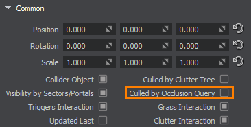

- In the Menu Bar, toggle the Rendering -> Occlusion Culling -> Occlusion Query flag on to enable testing for the scene before sending data to the GPU.
在菜单栏中,将Rendering -> Occlusion Culling -> Occlusion Query标志打开,以启用对场景的测试,然后再将数据发送到GPU。 - For all objects, that should be culled, enable the Culled by Occlusion Query flag in the Node tab of the Parameters window.
注意Only nodes with this flag set are tested on the hardware occlusion culling.Only nodes with this flag set are tested on the hardware occlusion culling.
Only nodes with this flag set are tested on the hardware occlusion culling.对于所有应该剔除的对象,在ParametersCulled by Occlusion Query窗口的Node选项卡中启用标志。注意Only nodes with this flag set are tested on the hardware occlusion culling.仅对设置了此标志的节点进行硬件遮挡剔除测试。

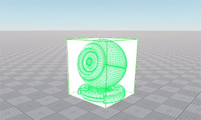

When culling is enabled for the object, an occlusion query box is rendered for it.为对象启用剔除后,将为其呈现遮挡查询框。

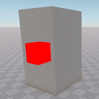

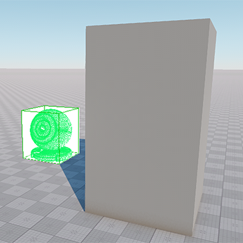

The occlusion query box coincides with the size of the object's bounding box. When this box is overlapped (i.e. it isn't in the camera viewport), it is highlighted red, which means the occlusion test is not passed and the mesh will not be drawn.遮挡查询框与对象边界框的大小一致。当此框重叠时(即不在相机视口中),将突出显示红色,这意味着未通过遮挡测试并且将不会绘制网格。
Occlusion query test passed遮挡查询测试通过 |
Occlusion query test failed, material ball isn't rendered遮挡查询测试失败,未显示实物球 |
