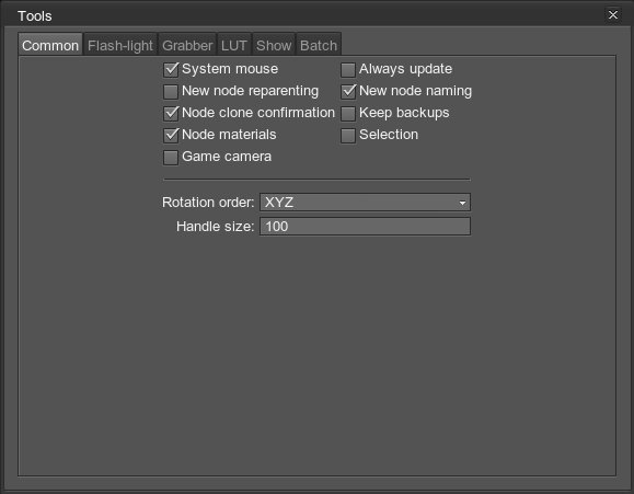

Common
The tab provides options that enable/disable display of additional information.
System mouse | Show system mouse cursor. If the mouse is processed as GUI element, it will be FPS dependent. |
New node reparenting | Create a new node as a child of the currently selected node. |
Node clone confirmation |
Node materials |
Game camera |
Always update | Update Unigine application window even when it is not in focus. |
New node naming | Generate a name for a new node. When the new node is added, automatically assign the file name as the node name (for example, when my_mesh.mesh is added, a node will have a name my_mesh_0). This option is available for meshes, skinned meshes, reference nodes and layer nodes. |
Keep backups | Save backups when reference nodes are edited. This option allows for safe editing of reference nodes (even if the crash occurs, their data will not be lost). |
Selection | For most of numerical parameters, automatically select parameter value after it has been entered (instead of selecting it manually in order to change it). This option allows for quick resetting of values until the right one is found. |
Rotation order | Controls which axis goes first when a node is rotated. The default value is XYZ. |
Handle size | The size of the object handler. |

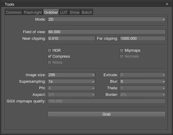

Grabber
The tab allows grabbing of the rendered image into a 2D texture, cube map, light map or impostor.
