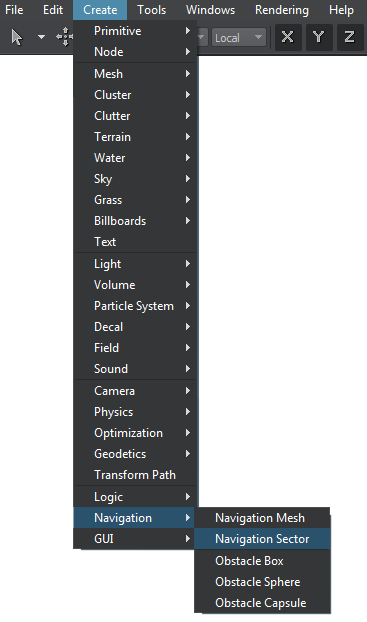

To create a navigation sector via UnigineEditor:
- Run UnigineEditor.
- On the Menu bar, click Create -> Navigation -> Navigation Sector.
- Click somewhere in the world to place the navigation sector.

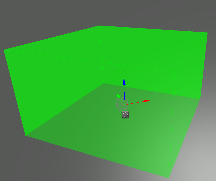

A navigation sectorThe new navigation sector will be added to UnigineEditor and you will be able to edit it via the Parameters window.
The created navigation sector only provides an area within which the 2D and 3D routes are calculated. The routes themselves should be created from the script.

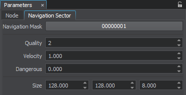

In the Navigation Sector tab of the Parameters window, you can adjust the following parameters of the navigation sector:
Navigation | Navigation mask. The navigation mask of the navigation sector must match the navigation mask of the route that is calculated within it. Otherwise, the sector will not participate in pathfinding. By using the navigation mask, you can specify sectors that must be ignored during pathfinding. |
Quality | Quality of optimization of the route that has already been calculated. This value specifies the number of iterations that are used for taking the short cut. The higher the value, the longer the route calculation will take. |
Velocity | Scaling factor for velocity of the point that moves inside the navigation sector along the calculated route. |
Dangerous | Danger factor that indicates if the point that moves inside the sector should try to avoid the navigation sector.
If the danger factor exceeds the maximum danger factor set for the route, the navigation sector will be excluded from pathfinding calculations. |
Size | Size of the navigation sector's box along the axes. |
