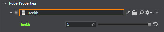

  1. Create the Health component and copy the following code into it:创建一个名为 Health 的组件,并复制以下代码:

    Save all the files that we modified and then build and run the application by hitting Ctrl + F5 to make the Component System update properties used to assign the components to nodes. Close the application after running it and switch to UnigineEditor.保存所有已修改的文件,然后在 IDE 中按 Ctrl + F5 编译并启动应用程序,以便组件系统生成用于将组件绑定到节点的属性。启动后关闭应用并返回 UnigineEditor。
  2. Add it to the visuals node of the robot_enemy node.将组件添加至robot_enemy节点的visuals节点。
  3. Add it to the player_hit_box node of the player node.将组件添加至player节点的player_hit_box节点。
