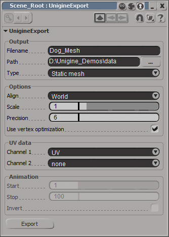

- Set up export options.
Mesh, skinned mesh and skinned mesh animation export options
Export Options
The following options are available for export customization:
- Output:
- Filename — name of the exported file.
- Path — folder path to the file.
- Type — format geometry will be exported into:
- Static mesh (.mesh file)
- Skinned mesh (.smesh file)
- Animation frames (.sanim file)
- Spline (.spline file)
- Export:
- Align — a point that will be used as the origin of coordinates:
- World — use the world origin of coordinates.
- Local — use the local origin of coordinates.
- Center — use the center of the object's bounding sphere.
- Bottom — use the bottom of the object's bounding sphere.
- Top — use the top of the object's bounding sphere.
- Scale — scaling ratio.
- Precision — required precision. Number of digits after a decimal point to keep.
- Use vertex optimization — optimization that reorders an indexed triangle list for improved vertex cache utilisation.
- UV data:
- Channel 1 — UV channel that should be copied into the first channel of an exported file. If None is chosen, the channel will be left empty.
- Channel 2 — UV channel that should be copied into the second channel channel of an exported file. If None is chosen, the channel will be left empty.
- Animation (available only if Skinned mesh or Skinned mesh animation types are selected):
- Start — the first frame of the exported animation.
- Stop — the last frame of the exported animation.
- Invert - reverse the animation. In this case the exported animation will be played from the Stop frame to the Start one.
