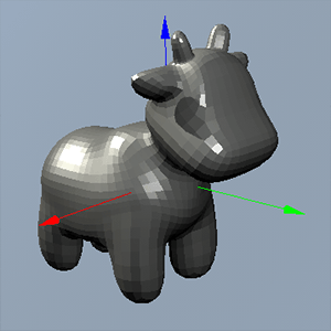

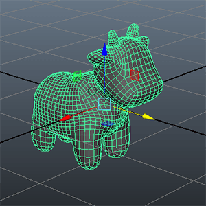

A direction vector is the important concept of mesh transformation. To move the node forward, you should know where is the forward direction of the mesh. When the mesh is exported from a 3D editor, it saves the information about the forward direction. And when you add the mesh to the Unigine, it will have the same orientation as it had in a 3D editor.
A mesh in Maya |
The same mesh in Unigine |
On pictures given above, the direction vector has positive Y-direction. To move this mesh forward, you should get the direction of the mesh by using the Y component (the second column) of the world transformation matrix of the mesh.
