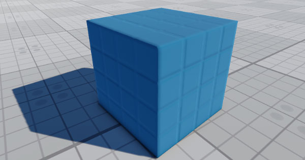

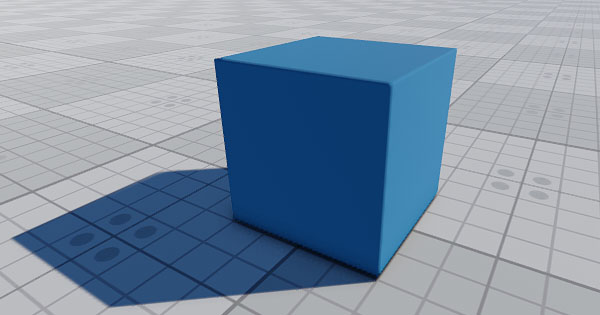

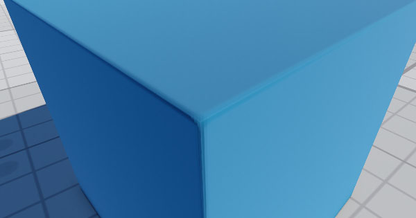

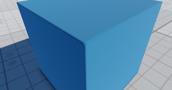

The section contains settings that control screen-space bevels. Using bevels allows you to create smoothed edges of geometry and gives a realistic look to objects in the scene.

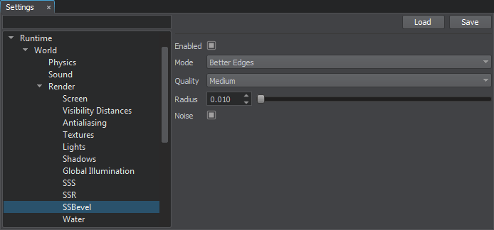

Screen-Space Bevel Settings
Settings are applied to materials with the SSBevel state enabled.
Enabled | Toggles bevels on and off. |
Mode | Sets the mode of the screen-space bevels rendering. Available values:
Quality | Quality of the screen-space bevels:
Radius | The size of the screen-space bevel effect. |
Noise | Toggles the noise that allows smoothing bevels on and off. It is recommended to use the noise with TAA enabled to avoid visual artifacts. The bevel noise is applied at a certain distance from the camera (i.e. if the camera is too far from the object with bevels, the noise won't be applied). |

- Via the Render Settings window: go to the Windows -> Settings -> Runtime -> Render -> SSBevel section and click Enabled.
- In the Main Menu select Rendering -> Features and choose SSBevel.
- In the Render Settings window, specify the global SSBevel settings described above.
