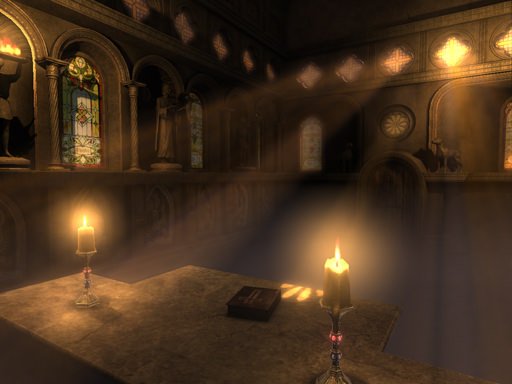

Volumetric objects are used to simulate different kinds of volumes depending on their materials:
- Visible light volumes (they are not light sources, therefore, they don't illuminate the scene):
- Spheres of light around omnidirectional light sources
- Beams from directional light sources
- Light volumes around flat light emitters
- Sun beams falling into a room through openings
- Fog that obscures objects inside its volume
- Clouds or shaped fog
