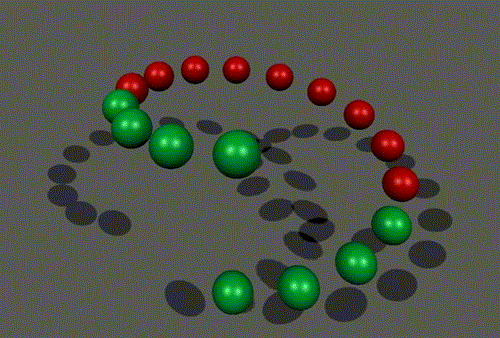

Each object is composed of a switcher and two spheres of different colors

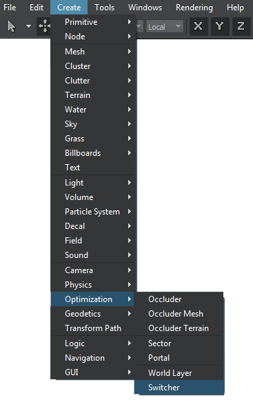

To add a switcher to the scene via UnigineEditor, do the following:

To switch between two object at the specified distance (like shown at the picture above), do the following:

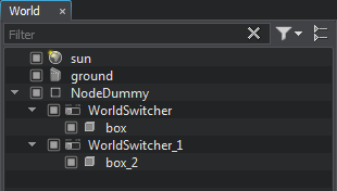

- Create a node dummy for convenient grouping.
- Make the first switcher the child of the node dummy.
- Make the first object the child of the first switcher and specify its maximum visibility distance.
- Make the second switcher the child of the node dummy.
- Make the second object the child of the second switcher and specify its minimum visibility distance.
NoticeFor objects to be switched at the same point, the maximum visibility distance of the first and minimum visibility distance of the second should match.

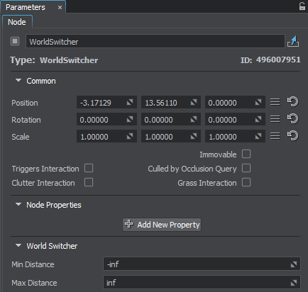

In the Node tab of the Parameters window, you can adjust the following parameters of the switcher:
Node tab of the World Switcher node
