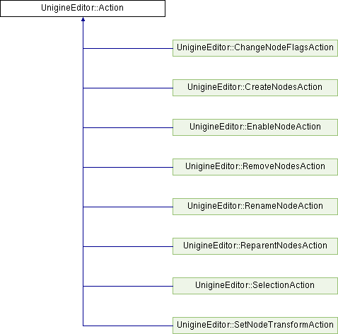

Inheritance diagram for UnigineEditor::Action:
UnigineEditor::ChangeNodeFlagsAction UnigineEditor::CreateNodesAction UnigineEditor::EnableNodeAction UnigineEditor::RemoveNodesAction UnigineEditor::RenameNodeAction UnigineEditor::ReparentNodesAction UnigineEditor::SelectionAction UnigineEditor::SetNodeTransformAction
