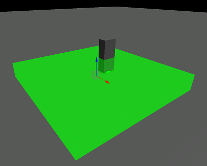

- Place the required node inside the navigation area within which routes will be calculated.
A cuboid-shaped ObjectMeshDynamic node placed inside the navigation sector

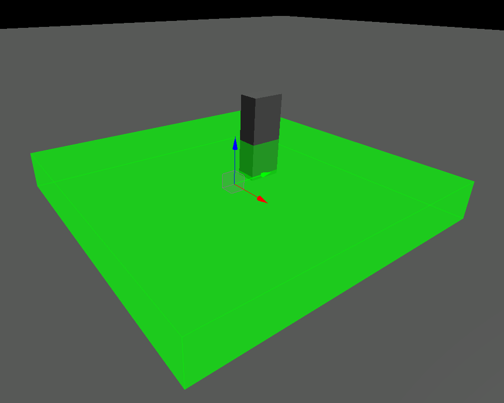

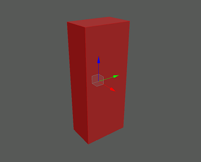

- Add the obstacle of the required type to the scene and combine its position with the node's position.
- Set the required size for the obstacle.
The obstacle box and the node.

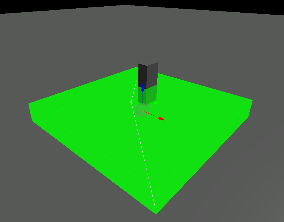

- Now you can create a route from the script. The route will be automatically recalculated when the node transformation changes.
In the result, the route will be calculated as follows (the route is highlighted with white):
The route that bypasses the node marked as the obstacle box.
