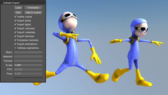

Collada plugin in Unigine engine

Collada import plugin is now shown:
Collada plugin interface

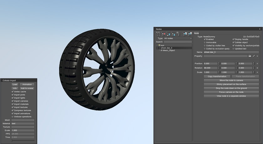

After loading the plugin, you can start creating your world from Collada assets right away. To load a Collada scene into the Unigine engine:
- Copy Collada assets under <UnigineSDK>/datafolder. This step is recommended if you want to save the Unigine world with converted meshes and textures.
- Click Load button in the Collada plugin window to load a Collada scene into the memory.
- Specify the path to the DAE file.
- If necessary, load an additional animation from another DAE file by clicking Animation button.
- Check import options (if materials, animations, joints, etc. do not need to be loaded).
- Click Add to scene button to add a loaded scene into Unigine world.
- If materials are imported, specify the path to the new or existing Unigine material library file (*.mat).

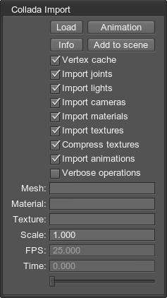

Plugin Options
Load | Loads one scene from a DAE file into the memory. After it is loaded, you can click Add to scene button.
Animation | Loads an additional animation stored in a separate file. This option is available only after an assets is loaded. (To load animation baked into the current DAE file, see Import animations.) |
Info | Displays information on the loaded file:
Add to scene | Adds a loaded scene into the Unigine world. Loaded data is saved from memory to the disk (if a source Collada file is stored under data directory). What data is saved depends on the selected import options (such as Import materials, Import animations).
Vertex cache | Performs vertex cache optimization. This option reorders an indexed triangle list to improve vertex cache utilization in run time. It can be turned off for a quicker saving; however, it should always be turned on if saving the final version. |
Import joints | Imports the hierarchy of the joints (bones) for animated Collada assets. Joints are imported as a hierarchy of Dummy nodes. If this option is disabled, imported animations for a mesh still work. |
Import lights | Imports light sources from a Collada scene into Unigine:
Import cameras | Imports cameras from a Collada scene. They are converted into PlayerDummy (cameras without physical properties). Both types of projection are supported in Unigine:
Import materials | Creates materials for the imported scene. They include:
Import textures | Converts textures into Unigine-ready, optimized for real-time DDS formats:
Compress textures | Compresses textures and creates mipmaps, if necessary. This option requires Import textures option to be checked as well. |
Import animations | Imports animation for animated Collada assets. This option imports animation baked into the current DAE file. (To load animation baked into a separate DAE file, see Animation.) The following types of animation are supported:
To control the animation for the last loaded scene, drag the slider at the bottom of the plugin window. ![]() Baked animation
Verbose operations | Displays a dialog if meshes or textures need to be rewritten (when a Collada scene is added into the Unigine world for the second time or more). |
Mesh | Adds a prefix to the name of created meshes. For example, with a prefix my_, a mesh MeshName will be imported as my_MeshName. |
Material | Adds a prefix to the name of created materials. For example, with a prefix prefix_, an imported material will be named as prefix_MeshName. |
Texture | Adds a prefix to the name of created textures. For example, with a prefix prefix_, an imported texture will be named as prefix_TextureName. |
Scale | Scales the imported scene. |
FPS | Sets FPS for the imported animation. |
Time | Sets the frame for the imported animation. You can also set it on a time line by dragging a slider. |
