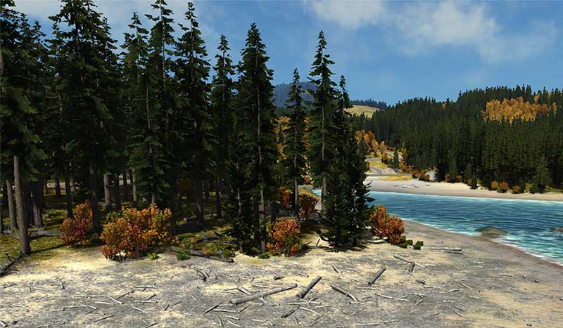

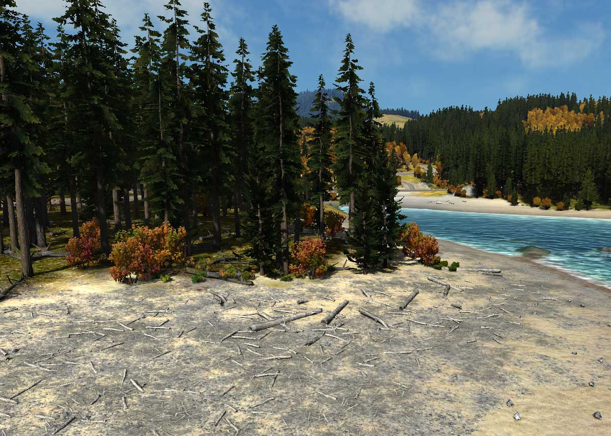

Mesh Decal
A mesh decal is a decal based on the arbitrary .mesh file and projected onto a surface by means of the orthographic projection.
This decals are always of the same size regardless of the projection box location relatively to the projection surface.
Roads Based on the Mesh Decal
