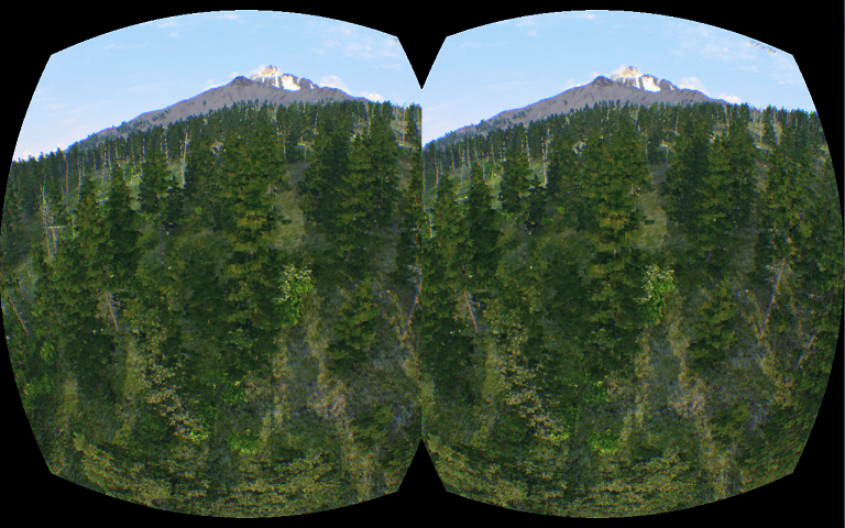

The AppOculus plugin provides the VR mode that allows for rendering to both the Oculus Rift head-mounted display and the PC display. When the VR mode is disabled, the image is rendered only to the PC display. The mode can be toggled by using the engine.oculus.setEnabled() function.
Both the windowed and the full screen modes are supported. On the PC display the image is rendered as follows:

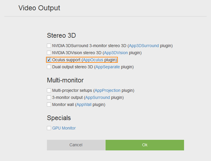

- Create a new project with AppOculus support via Unigine SDK Browser: click Video Output Options, check the Oculus support (AppOculus plugin) option in the form that opens and clickOk.
NoticeTo add Oculus support to an existing project, in Unigine SDK Browser, click Other Actions ->Configure Project -> Video Output Options -> Oculus support (AppOculus plugin) -> Ok.

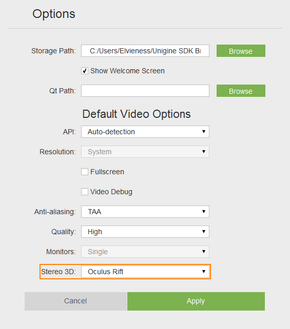

If you run the application via Unigine SDK Browser, set the Stereo 3D option to Oculus Rift in the Options tab and click Apply:
AppOculus Options
