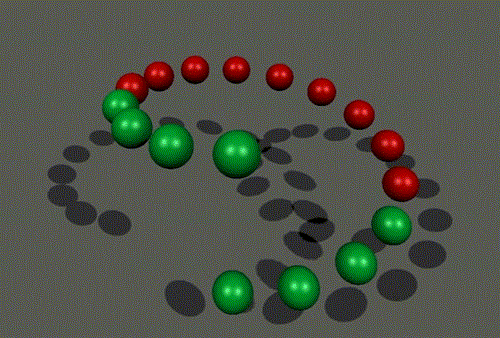

Each object at the picture is composed from a switcher and 2 spheres of different color.

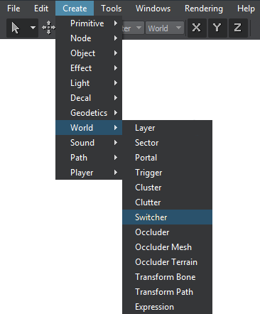

To add a switcher to the scene via UnigineEditor, do the following:
- Run the project with UnigineEditor.
- On the Menu bar, click Create -> World -> Switcher.
- Place the object somewhere in the world.
- Make the object that will be operated the child of the switcher.
- Specify the switcher parameters and the distance of enabling / disabling.

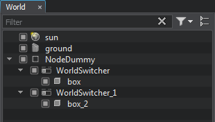

Switching between Two Objects
To switch between two object at the specified distance (like shown at the picture above), do the following:
- Create a node dummy for convenient grouping.
- Make the first switcher the child of the node dummy.
- Make the first object the child of the first switcher and specify its maximum visibility distance.
- Make the second switcher the child of the node dummy.
- Make the second object the child of the second switcher and specify its minimum visibility distance.

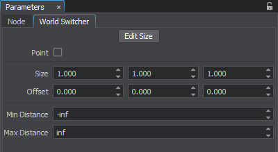

Switcher Parameters
In the World Switcher tab of the Parameters window you can adjust the following parameters of the switcher:
World Switcher tab
Edit Size |
Bounding Box Parameters
A set of bounding box parameters:
Point | A flag, indicating if the distance to the object is counted from the center of the bounding box (if disabled, the distance will be counted from its nearest edge). |
Size | The size of the switcher's bounding box along the X, Y and Z axes, in units. |
Offset | The offset of the switcher's bounding box along the X, Y and Z axes, in units. |
