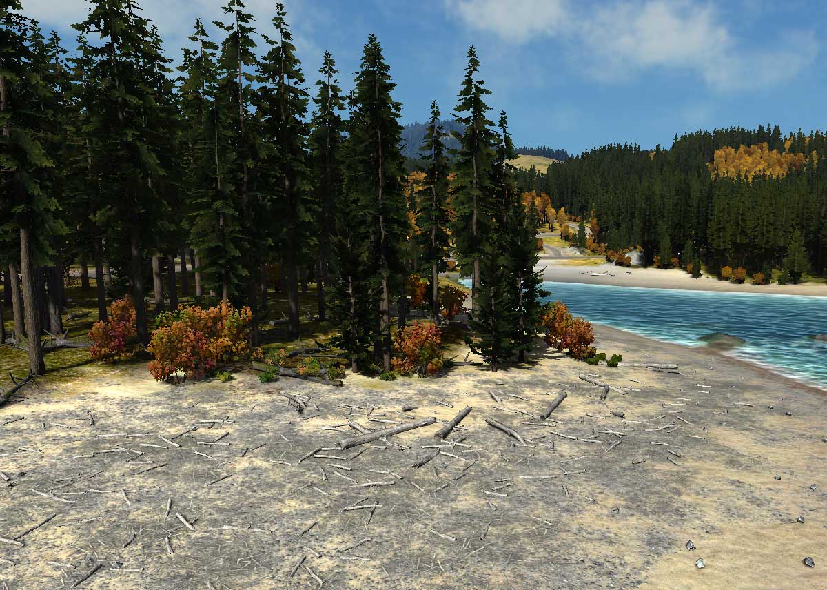

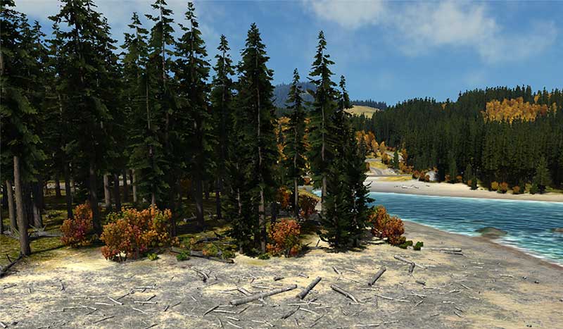

Mesh Decal
A mesh decal is a decal based on the arbitrary .mesh file and projected onto a surface by means of the orthographic projection.
- The mesh that is used for projection should contain a single surface. In case if the mesh contains several surfaces, only the one with the 0 index will be used. Thus, the area of the decal will differ from the initial mesh.
- The decals are always of the same size regardless of the projection box location relatively to the projection surface.
