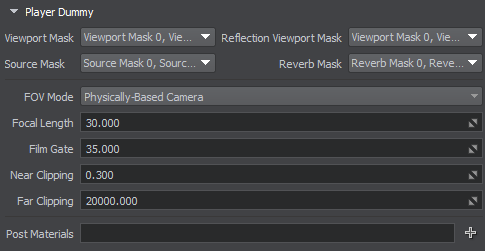

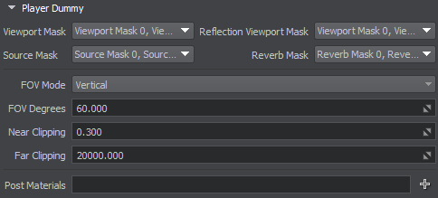

In the Player Dummy section of the Node tab, you can adjust the bit masks and viewing frustum parameters of the dummy player and assign post-process materials to be applied to the camera view.
Vertical Player Parameters
Physically-Based Player Parameters
