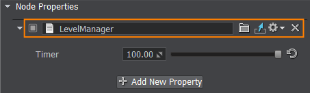

  3. Create a new Dummy Node called level_manager and place it somewhere in the world.
  4. Add a LevelManager component to the level_manager node via the Parameters window in the UnigineEditor.

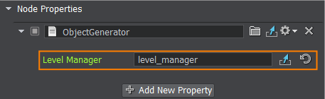

  3. Select the object_generator node in the World Nodes window and drag the level_manager node to the corresponding field of the ObjectGenerator property.
