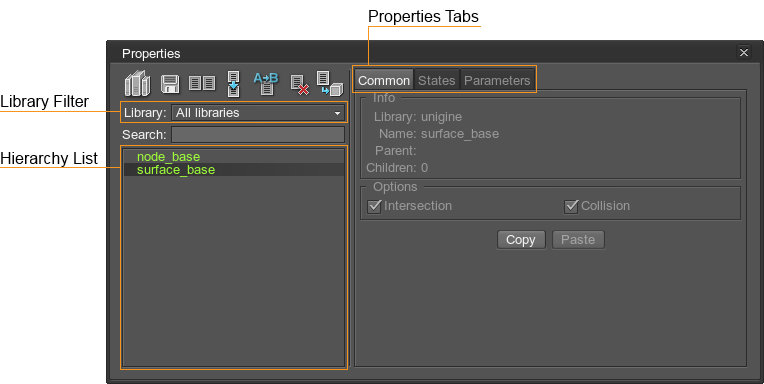

This panel is invoked by pressing the O key. It is used to modify and organize properties— sets of custom options, which can be assigned both to whole nodes and single surfaces. It consists of two panes: property tree and data related to the selected property and organised in tabs.

Properties Tree
The properties tree in the left part of the settings window has the following elements:

- Library filter — show all property libraries in the hierarchy list or filter the specific ones for displaying.
- Search — search property in the hierarchy list by name.
- Properties hierarchy list — hierarchically structured list of the properties giving property names and parent-child links.
Properties Tabs
The property-related data is grouped into four tabs:
- The Common tab contains the options common to all the properties.
- The States tab contains a set flags that define parameters.
- The Parameters tab contains parameters associated with the selected states.

Common Tab
The common tab has the following options:
Library | A library for the current property. |
Name | A name of the property. |
Parent | A name of the parent property. |
Children | The number of child properties. |
Intersection | Enable intersection test for the surfaces that have a property assigned. The surface will be tested for intersection only if both the property and the surface (Nodes options -> Surfaces tab -> Intersection box) options specify that. |
Collision | Enable collision test for the surfaces that have a property assigned. The surface will be tested for collision only if both the property and the surface (Nodes options -> Surfaces tab -> Collision box) options specify that. |
Copy | Copy all property settings. |
Paste | Apply the previously copied settings of the property to the current one. |
