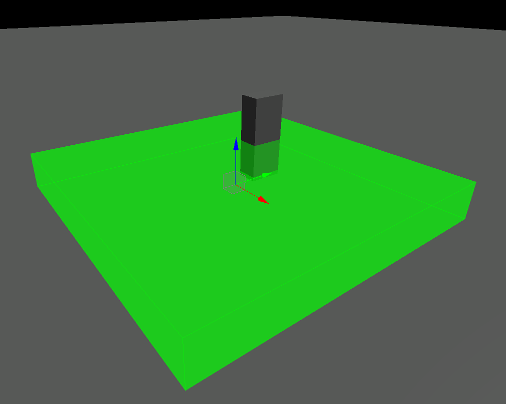

A cuboid-shaped ObjectMeshDynamic node placed inside the navigation sector

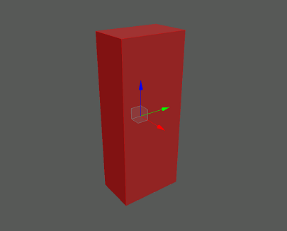

- Add the obstacle of the required type to the scene and combine its position with the node's position.
- Set the required size for the obstacle.

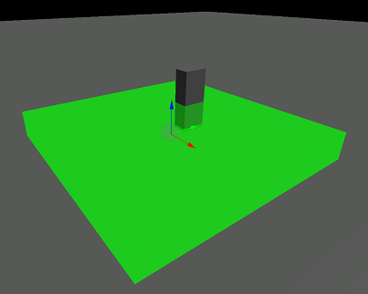

The obstacle box and the node.

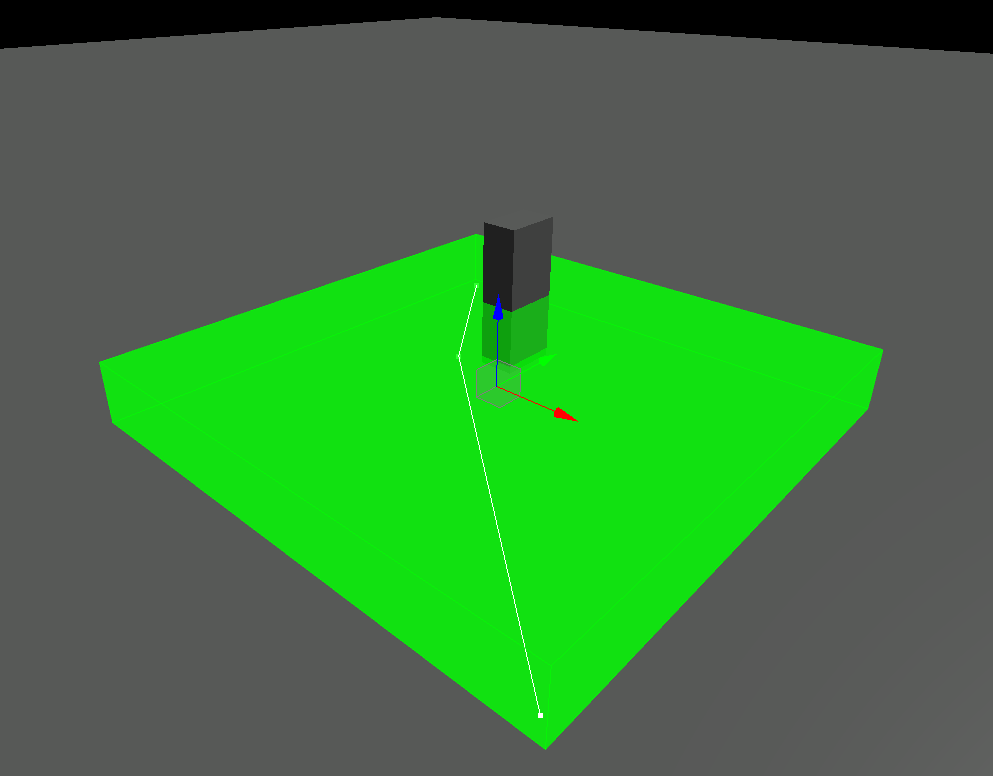

In the result, the route will be calculated as follows (the route is highlighted with white):
The route that bypasses the node marked as the obstacle box.
