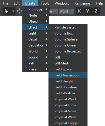

- Add an animation field to the world: on the Menu bar, choose Create -> Effect -> Field Animation and place the node in the world.
NoticeThe animation field will affect only those part of grass or vegetation that is inside it.

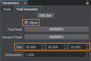

- Set up the added animation field: check the Ellipse option (if required), set the size of the field. For example:

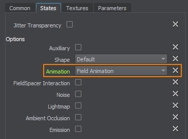

- In the Materials Hierarchy window, select the material applied to grass or vegetation and go to the States tab in the Parameters window. Change the value of the Animation option to Field. This will allow the field to affect the grass.

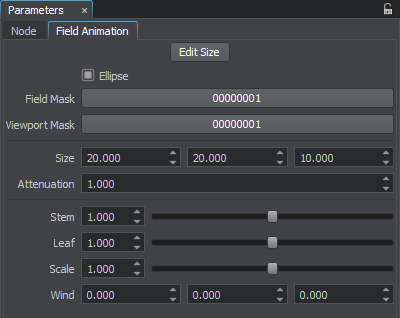

- In the Field Animation tab of the Parameters window, specify the required animation parameters. For example, you can increase the Stem option to 3 so that the movement amplitude of the grass inside the animation field differs from the movement amplitude of all the other polygons.

Stem | Scale for movement amplitude of grass and vegetation stems inside the animation field. |
Leaf | Scale for rotation angle of vegetation leaves inside the animation field. |
Scale | Scale for speed of vegetation swaying. |
Wind | Wind direction inside the animation field. |
