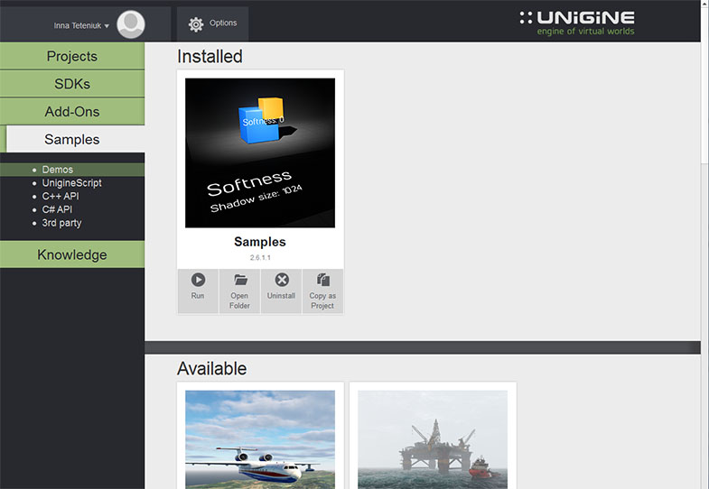

Samples are available via UNIGINE SDK Browser as a demo: go to Samples -> Demos and install the Samples demo. Then, you can run it for demonstration or copy as a project to modify the samples.
Samples Demo in UNIGINE SDK Browser
