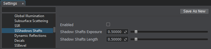

SSShadow Shafts
This section contains settings of the screen-space shadow shafts effect.
Screen-space shadow shafts settings
Enabled |
The value indicating if volumetric shadows are enabled. Enabled by default.
Console access: render_shadow_shafts (API control) |
Shadow Shafts Exposure |
The contrast used for volumetric shadows. By the value of 0.0f shadows are not seen. Rendering of shadow shafts must be enabled. Range of values: [0.0f, 1.0f]. The default value is 0.5f. Console access: render_shadow_shafts_exposure (API control) |
Shadow Shafts Length |
The relative length of volumetric shadows in the screen space. By the value of 0.0f shadows are not seen. By the value of 1.0f shadows are long enough to occupy the whole screen. Rendering of shadow shafts must be enabled. Range of values: [0.0f, 1.0f]. The default value is 0.5f. Console access: render_shadow_shafts_length (API control) |
