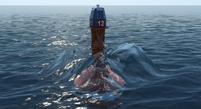

Water disturbance near the buoy is made by using FieldHeight object.

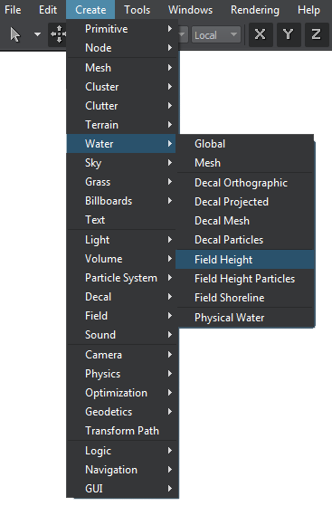

Adding Field Height#
To add a height field in the world via UnigineEditor, do the following:
- On the Menu bar, choose Create -> Water -> Field Height.
- Place the height field in the world so that it intersects Global Water object.
NoticeMake sure that the FieldHeight interaction option is enabled for water_global_base material.
- Go to the Field Height tab of the Parameters window and set up necessary parameters.
After adding a Field Height object to the scene, you can't see any changes of the global water object because Field Height object doesn't have any default heightmap texture.

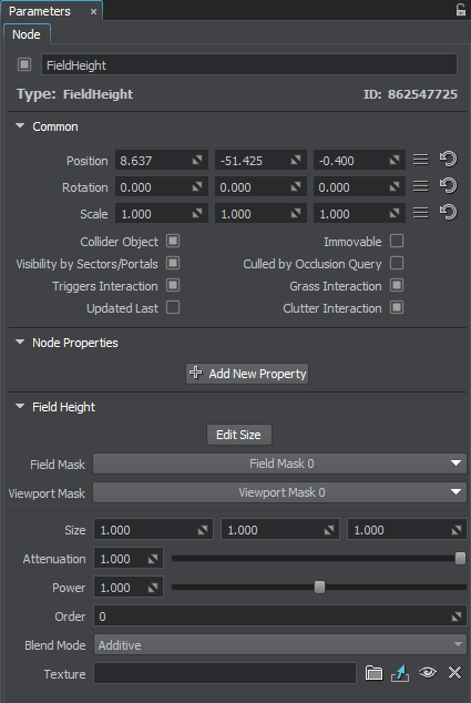

Setting Up Field Height#
In the Field Height section (Parameters window -> Node tab), the following parameters of the height field can be adjusted:
Setting Bit Masks#
Field Mask | A Field mask. A bit mask that specifies an area of the height field to be applied to water. The height field will be applied to water only if they have matching masks. |
Viewport Mask | A Viewport mask. A bit mask for rendering the height field into the current viewport. For the height field to be rendered into the viewport, its mask should match the camera Viewport mask. |
Setting Height Parameters#
Size | Size of the height field along the axes in units. |
Attenuation | An attenuation factor indicating how much global water object's heights gradually changing from the center of the height field.
Power | Power parameter is a multiplier for FieldHeight heightmap texture values.
Order | Rendering order of the Field Height. This parameter is used to properly apply fields with mixed blend modes. |
Blend Mode | Bending mode of the Field Height. Available values are Additive, Multiplicative.
The Attenuation parameter is interpreted depending on the selected blending mode:
Texture | Heightmap R16 or R32F (1-channeled) texture (controlled by the render_field_precision console command). Heightmap texture is used to create an additional height displacement for water surface. |
