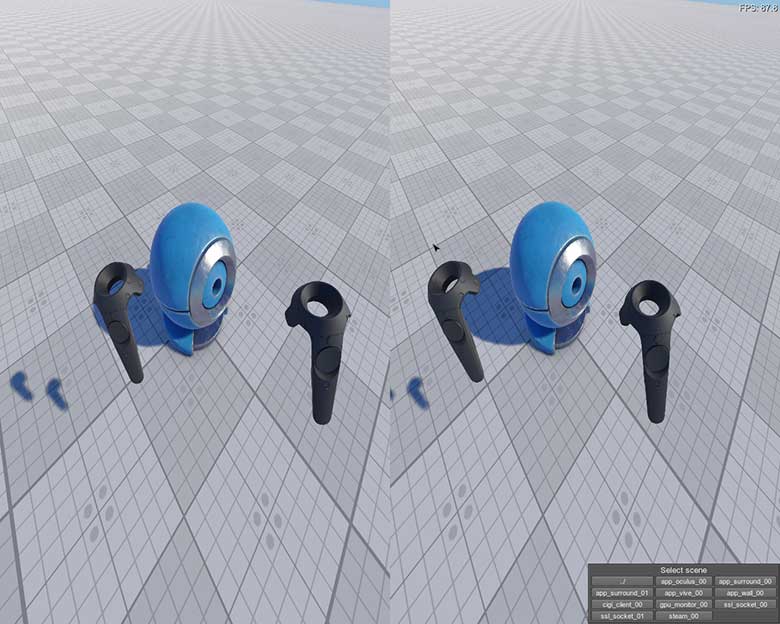

Both the windowed and the full screen modes are supported. By default, on the PC display the image is rendered in mono mode (image from the left eye). Use setViewportMode() to change the mode to stereo (both eyes) as follows:窗口模式和全屏模式均受支持。默认情况下,在PC显示器上以单模式渲染图像(左眼图像)。使用setViewportMode()将模式更改为立体声(双眼),如下所示:

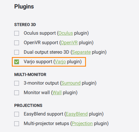

  2. Create a new project with Varjo support via UNIGINE SDK Browser: click Plugins, check the Varjo support (Varjo plugin) option in the form that opens and click OK. 通过UNIGINE SDK浏览器创建具有Varjo支持的新项目:单击插件,选中 Varjo支持(Varjo插件)选项在打开的表单中,然后点击确定
    To add Varjo support to an existing project, in UNIGINE SDK Browser, click Other Actions -> Configure Project -> Plugins -> Varjo support (Varjo plugin) -> OK. 要将Varjo支持添加到现有项目,请在UNIGINE SDK浏览器中,单击Other Actions -> Configure Project -> Plugins -> Varjo support (Varjo plugin) -> OK.
