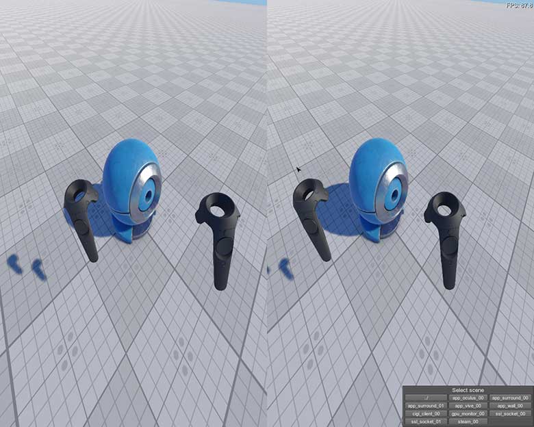

带有OpenVR插件的HTC Vive输出
The OpenVR plugin is used to support both the HTC Vive and the HTC Vive Pro head-mounted displays. It is supposed that you already have HTC Vive/Vive Pro HMD installed. SteamVR will be set automatically on the HTC Vive (HTC Vive Pro HMD) installation.OpenVR插件用于支持HTC ViveHTC Vive Pro头戴式显示器。假定您已经安装了HTC Vive/Vive Pro HMD。 SteamVR将在HTC Vive (HTC Vive Pro HMD)安装中自动设置。
Both the windowed and the full screen modes are supported. By default, on the PC display the image is rendered in mono mode (image from the left eye). Use setViewportMode() to change the mode to stereo (both eyes) as follows:窗口模式和全屏模式均受支持。默认情况下,在PC显示器上以单模式渲染图像(左眼图像)。使用setViewportMode()将模式更改为立体声(双眼),如下所示:

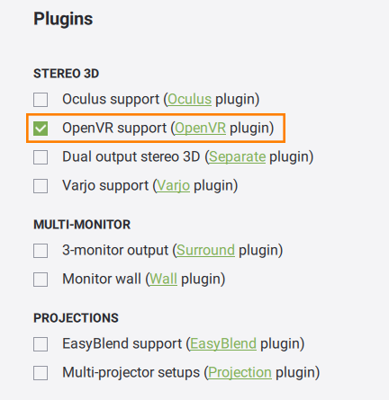

  2. Create a new project with Vive support via UNIGINE SDK Browser: click Plugins, check the OpenVR support (OpenVR plugin) option in the form that opens and click OK. 通过UNIGINE SDK浏览器创建具有Vive支持的新项目:单击Plugins,在打开的表单中检查OpenVR support (OpenVR plugin)选项,然后单击OK
    To add OpenVR support to an existing project, in UNIGINE SDK Browser, click Other Actions -> Configure Project -> Plugins -> OpenVR support (OpenVR plugin) -> Ok. 要将Vive支持添加到现有项目,请在UNIGINE SDK浏览器中,单击Other Actions -> Configure Project -> Plugins -> OpenVR support (OpenVR plugin) -> Ok.

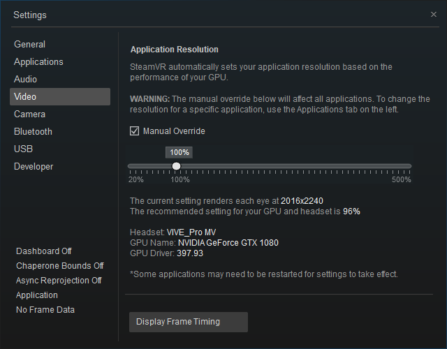

  • vive_render_width and vive_render_height - set a resolution for each eye. The default resolution for one eye is set equal to recommended value by SteamVR.
    Please note that by default SteamVR selects resolution based on your computer's performance. Therefore, for best image quality it is recommended to open the Video tab of the SteamVR settings window, enable Manual Override mode and set resolution to 100%. Please note that by default SteamVR selects resolution based on your computer's performance. Therefore, for best image quality it is recommended to open the Video tab of the SteamVR settings window, enable Manual Override mode and set resolution to 100%.
    So the resolution will be set as follows: So the resolution will be set as follows:
    HTC Vive HTC Vive Pro
    Resolution per eye 1512 x 1680 2016 x 2240
    The same resolution is set for both eyes.The same resolution is set for both eyes.
    Please note that by default SteamVR selects resolution based on your computer's performance. Therefore, for best image quality it is recommended to open the Video tab of the SteamVR settings window, enable Manual Override mode and set resolution to 100%. So the resolution will be set as follows:The same resolution is set for both eyes.
    vive_render_width vive_render_height -为每只眼睛设置分辨率。一只眼睛的默认分辨率设置为等于SteamVR的建议值。
    Please note that by default SteamVR selects resolution based on your computer's performance. Therefore, for best image quality it is recommended to open the Video tab of the SteamVR settings window, enable Manual Override mode and set resolution to 100%. 请注意,默认情况下,SteamVR根据计算机的性能选择分辨率。因此,为了获得最佳图像质量,建议打开SteamVR设置窗口的“视频”标签,启用手动覆盖模式并将分辨率设置为100%。
    So the resolution will be set as follows:因此,分辨率将设置如下:
    The same resolution is set for both eyes.两只眼睛设置相同的分辨率。
