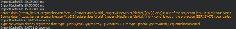

  • Open the Editor console (Windows -> Console). If something goes wrong, a console message might be useful in explaining the situation.打开编辑器控制台 (Windows -> Console)。如果出现问题,控制台消息可能有助于解释情况。
    Console errors
    Example of console errors控制台错误示例

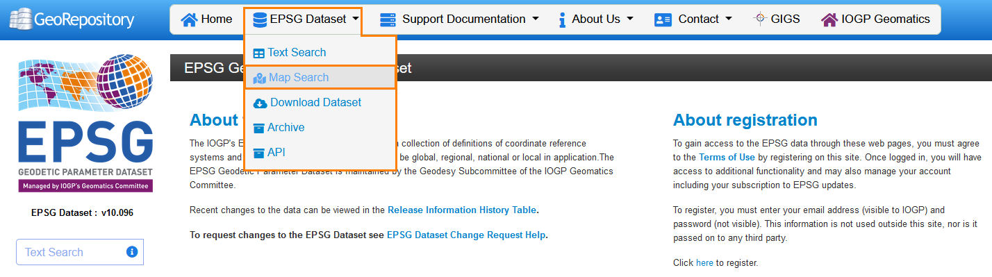

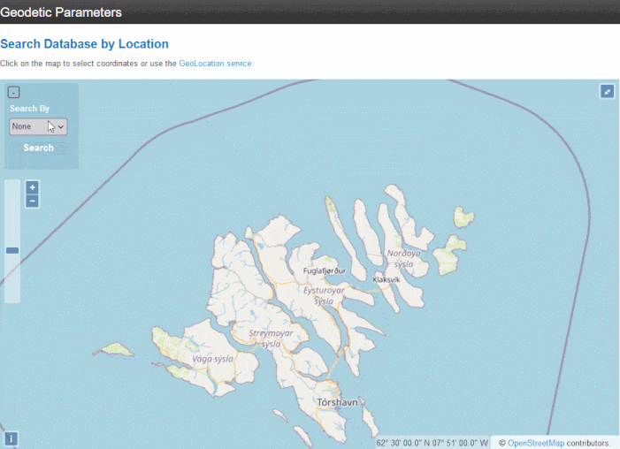

You can use https://epsg.org/ to find the best-fitting projection with minimum inaccuracy for the selected area.您可以使用https://epsg.org/ 为所选区域找到误差最小的最佳拟合投影。
How to use https://epsg.org/:如何使用https://epsg.org/:
  1. Go to EPSG Dataset -> Map Search:转到 EPSG Dataset -> Map Search:
    If the website doesn't display any map, consider disabling adblock or using a VPN.果网站不显示任何地图,考虑禁用广告屏蔽或使用VPN。
  2. Set the area boundaries and click Search. You’ll receive a table — sort it by type (click on the TYPE heading) and select one of the data sources that is marked as Projected.设置区域边界并单击 Search。您将收到一个表格,按类型对其进行排序(单击 TYPE 标题)并选择一个标记为 Projected 的数据源。

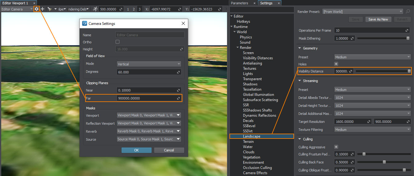

Change the camera visibility distance: in the Editor window, click the gear icon for the selected camera and increase the Far value. You can set the maximum, which is 900000.更改相机可见距离:在编辑器窗口中,单击所选相机的齿轮图标并增加 Far 值。您可以设置最大值,即 900000
Adjust the visibility distance for ObjectLandscapeTerrain. It is set in the Editor settings: Windows -> Settings -> Landscape -> Visibility Distance. You can set it to inf.调整 ObjectLandscapeTerrain 的可见距离。它在编辑器设置中设置:Windows -> Settings -> Landscape -> Visibility Distance。您可以将其设置为 inf

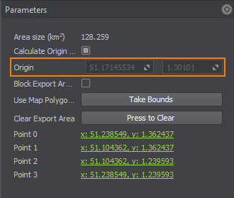

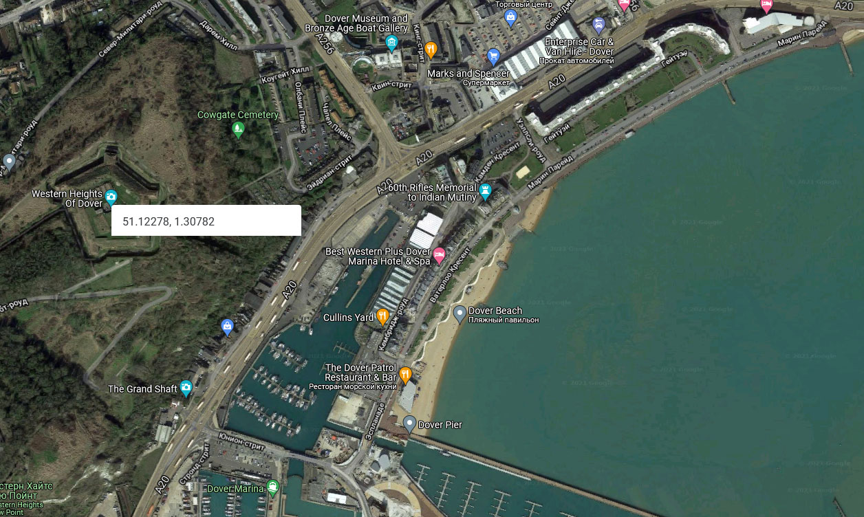

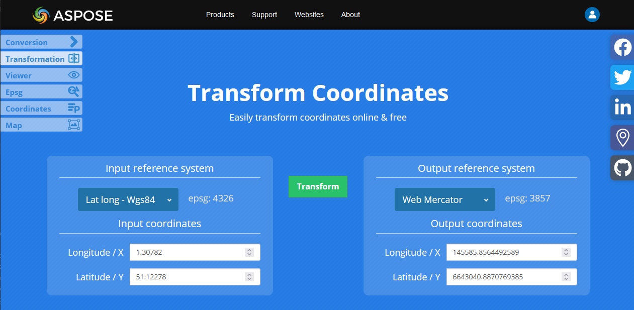

  • Transform the object and the origin coordinates to the world coordinates (mind the input and output projections).将对象和原点坐标转换为世界坐标(注意输入和输出投影)。
    对象的源坐标
    Source coordinates of the object (screen capture from Google Maps)对象的源坐标(来自谷歌地图的屏幕截图)
    原点的源坐标
    Source coordinates of the origin (Export Area parameter in Sandworm)原点的源坐标(Sandworm 中的导出区域参数)
    使用 aspose.app 变换坐标
    Transforming coordinates using aspose.app使用 aspose.app 变换坐标

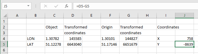

  • Take the origin position from the object position: Object.X — Origin.X; Object.Y — Origin.Y.从物体位置取原点位置:Object.X — Origin.X; Object.Y — Origin.Y
    计算场景(世界)中的坐标
    Calculating the world coordinates计算场景(世界)中的坐标
  • Use the outcome as the X and Y coordinates of the object in the world.将结果用作世界中对象的 X 和 Y 坐标。

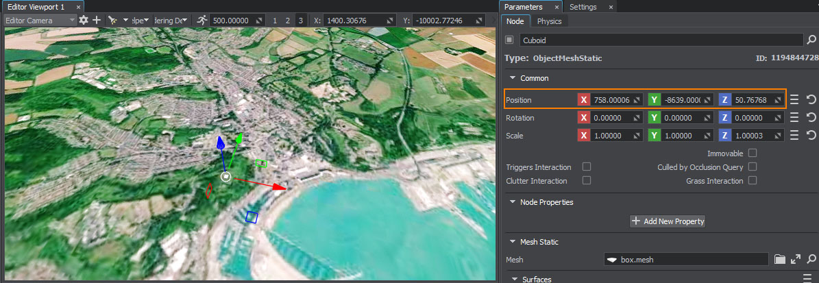

    对象定位在世界上
    Object positioned in the world对象定位在世界上
