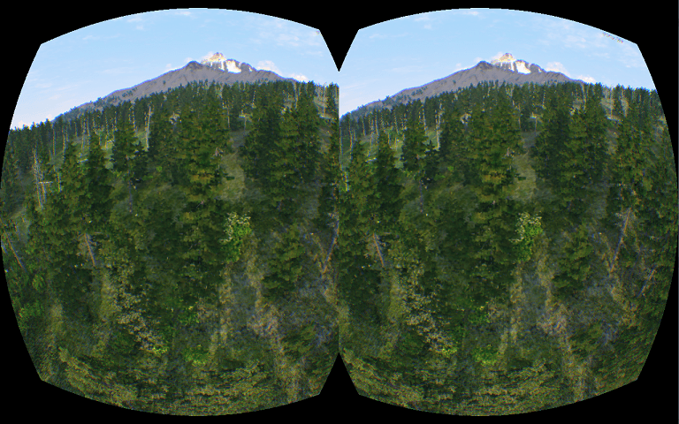

Both the windowed and the full screen modes are supported. On the PC display the image is rendered as follows: 窗口模式和全屏模式均受支持。在PC显示屏上,图像呈现如下:
Valley benchmark rendered on PC display with Oculus使用Oculus在PC显示器上呈现的Valley基准

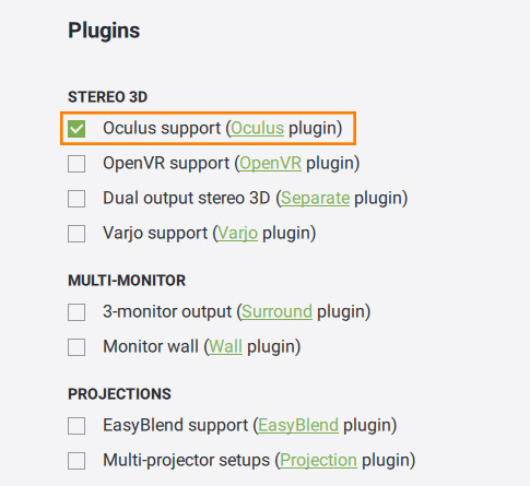

  2. Create a new project with Oculus support via UNIGINE SDK Browser: click Video Output Options, check the Oculus support (Oculus plugin) option in the form that opens and click OK.
    To add Oculus support to an existing project, in UNIGINE SDK Browser, click Other Actions -> Configure Project -> Video Output Options -> Oculus support (Oculus plugin) -> Ok. To add Oculus support to an existing project, in UNIGINE SDK Browser, click Other Actions -> Configure Project -> Video Output Options -> Oculus support (Oculus plugin) -> Ok.
    通过UNIGINE SDK浏览器创建一个具有Oculus支持的新项目:单击视频输出选项,选中表单中的 Oculus支持(Oculus插件) 选项随即打开,然后点击确定
    To add Oculus support to an existing project, in UNIGINE SDK Browser, click Other Actions -> Configure Project -> Video Output Options -> Oculus support (Oculus plugin) -> Ok. 要将Oculus支持添加到现有项目中,请在UNIGINE SDK浏览器中,单击Other Actions -> Configure Project -> Video Output Options -> Oculus support (Oculus plugin) -> Ok.
