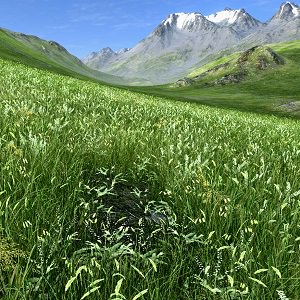

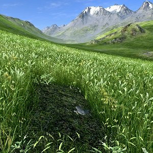

- A field spacer can be used to specify area under a building and around it where grass should not grow. Moreover, by using the attenuation factor, it is possible to create thinner grass around the building.

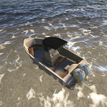

Boat without the spacer field: water is inside the boat

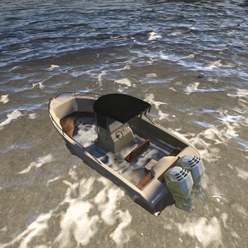

Boat with the spacer field: the spacer field cuts water off

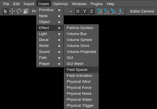

- On the Menu bar, choose Create -> Effect -> Field Spacer.

- In case of grass, the spacer field should intersect the surface, on which grass grows.

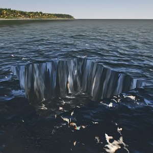

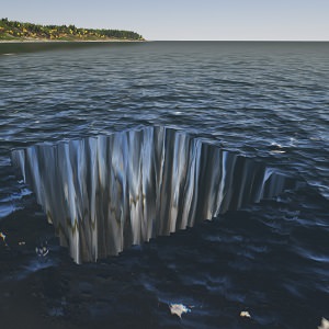

- In case of water, the spacer field should be submerged into water on the required depth. For example, the following pictures demonstrate the same spacer field submerged on different depth:

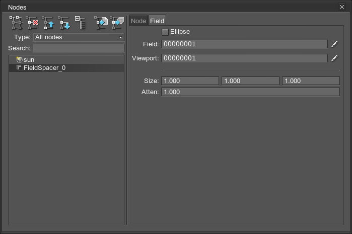

On the Field tab of the Nodes panel, the following parameters of the spacer field can be adjusted:
Setting Form of Spacer
Ellipse | Indicates whether the spacer field is ellipsoid-shaped. If unchecked, the spacer field has a form of a cube. |
Setting Bit Masks
Field | A field mask. A bit mask that specifies an area of the spacer field to be applied to grass or water. The spacer field will be applied to grass or water only if they have matching masks. |
Viewport | A viewport mask. A bit mask for rendering the spacer field into the current viewport. For the spacer field to be rendered into the viewport, its mask should match the camera viewport mask. |
