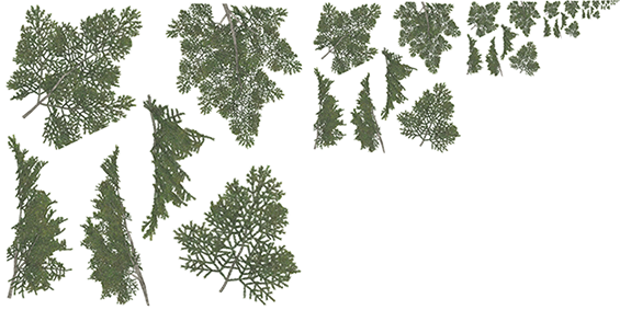

  1. Model several small branches with leaves and bake the models into texture atlases — the obtained textures are going to be your foliage textures. Here are examples of such textures:

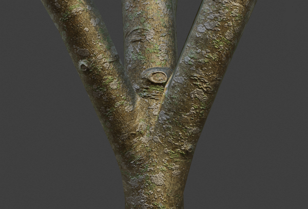

  3. Create the trunk with large branches and levels of detail for it. Prepare and assign necessary textures and materials.
    Trunk LODs
    Also, it is recommended to transfer normals from the trunk to the adjoined vertices of branches to make a more natural look of joints:
    Adjusted normals of branches at joints provide a more natural look

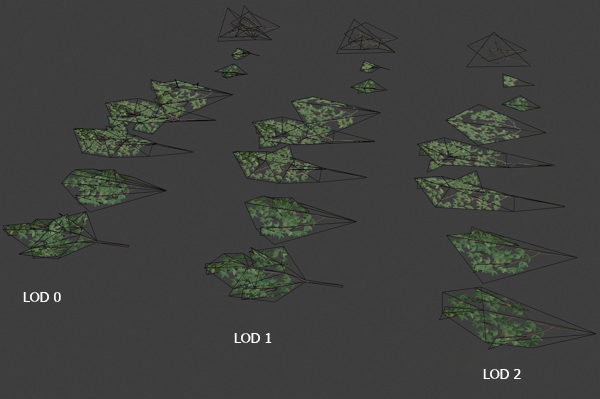

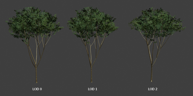

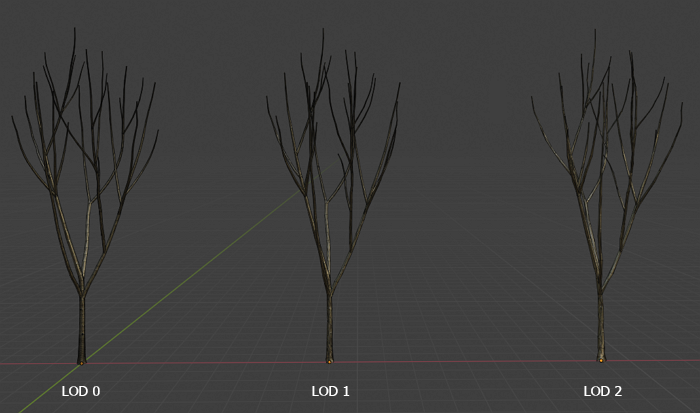

  4. Scatter the LODs of foliage chunks over branches of the corresponding trunk LODs forming the tree crown:
    Tree LODs
    The fact that the same number of chunks is used on all LODs may result in a higher polygon count. However, this approach has a number of advantages:

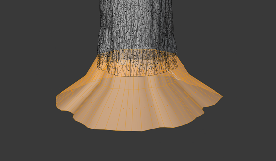

  6. For better blending with terrain, prepare a separate bottom part of the trunk with a new material assigned. You can merge it to the mesh of the highest LOD for convenience:
    Bottom part of the tree for blending with terrain

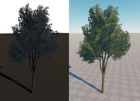

  • If specular highlights are incorrect, it is recommended to set the Specular value to 0.
    Incorrect lighting on flat leaves
    Incorrect lighting on the Reflections Rendering Debug preview (left) and the result image (right)

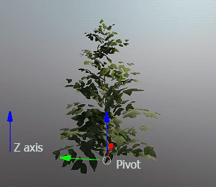

Thus, it is necessary to place the pivot point at the correct position (usually, it is the bottommost point of the stem) and orient the model, so the Z axis goes upwards.

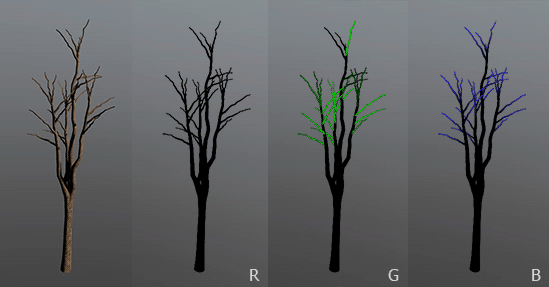

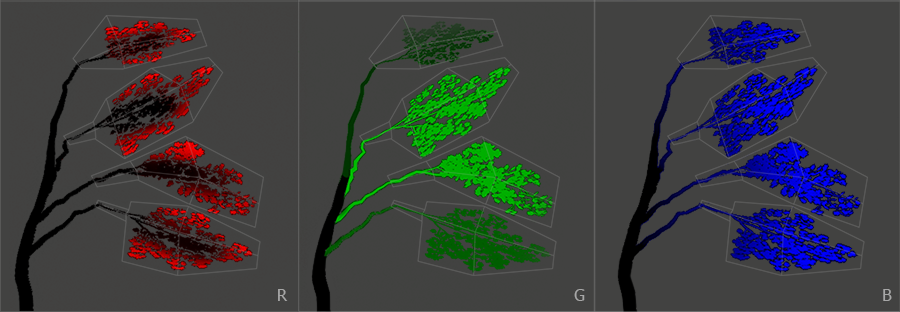

Vegetation movements are defined by RGB channels of vertex colors as follows:
Red channel is used for animation of smaller or peripheral parts of vegetation (leaves). Bright parts are animated, and dark parts are stiff.
Green channel is used to define the movement order for branches in order to desynchronize them. The movement sequence starts from the brightest element to the darkest.
Blue channel is used to define which parts of branches can be bent. Brighter parts indicate bendable portions, and darker parts — stiff portions.

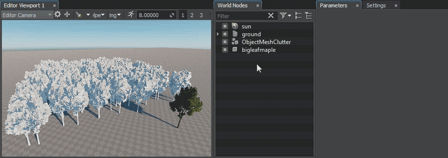

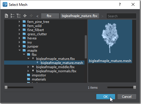

To randomly scatter a significant number of identical meshes across the terrain, Mesh Clutter is used. Mesh Clutter scatters objects procedurally and renders only those objects which are in the viewing frustum. The typical workflow is as follows:

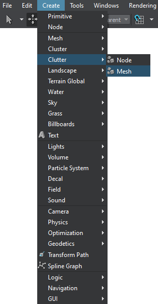

  1. Click Create -> Clutter -> Mesh and specify the .mesh asset to be used as the source mesh for the Mesh Clutter. Click within the viewport to place the new node in the world.
    .fbx assets are containers for .mesh assets, right-click on the asset and choose Open or double-click on it to access its content.
  2. If you already have a configured tree in your world, you can copy all materials and parameters from surfaces of the configured tree and paste them sequentially or by surface names to Mesh Clutter.
  3. Place the node in the scene and set the Size to cover the whole playable area.
    The operation of Mesh Clutter objects is float-based, so it is not recommended to use Sizes bigger than 10000 units lengthwise and widthwise. If you need to fill areas beyond this limit, you will need to manually split the single Mesh Clutter object into a grid of several clutters.
    The Sandworm Tool does the slicing automatically when generating terrain.
  4. Adjust the scattering parameters: set the desired Density in meshes per square unit; diversify the appearance of the forest by randomizing the Scale, Offset, and Rotation parameters.
  5. Make the clutter object child to the terrain and enable the Intersection flag to make trees follow the surface.
    If the Intersection flag is enabled, toggle it off and on to forcefully re-generate the Clutter object.

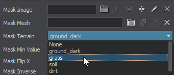

  7. By default, trees are scattered across the whole area. You can mask areas with vegetation via the following approaches:
    • By using a single-channel texture. You can prepare a texture in third-party software or create a new one and draw the mask from scratch. All Mesh Clutter and Grass objects that use that texture are updated on the fly.
    • By using Landscape Terrain masks. You can use the data of Landscape Terrain masks to define the density of the vegetation, provided your world contains Landscape Terrain with configured masks: select the desired mask in the Mask Terrain parameter:

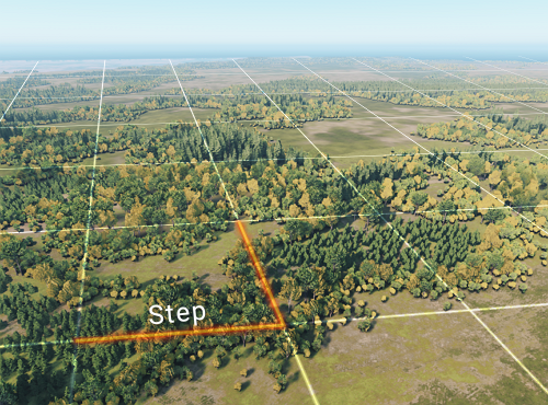

  8. Keep the optimal Step value for the best performance.
    The Clutter is rendered as a 2D grid, in each cell of which meshes are randomly scattered depending on the density and probability of appearing. Generation of meshes in the cells is time-sliced starting from the nearest cells to reduce the load on the CPU.
    Cell division
    The Step value defines the cell size in units. Thus, this value specifies the resulting number of cells along each axis (the size divided by the step). It is highly recommended to choose the values that are divided with no remainder.
    Each cell requires 1 DIP call, so the higher the number of cells (i.e., the smaller the step), the more reduced the performance is. However, creating a large cell takes a longer time. When the camera moves fast enough, small cells are created one by one very fast and smoothly, but large ones can noticeably pop into sight and cause a slight rendering lag.
You can scatter bushes and chunks of polygon grass across the terrain the same way.
A chunk of optimized polygon-based grass
Finally, by combining several clutters for different types of trees, bushes, and grass, you get a diverse look of vegetation.
Combination of several Mesh Clutter objects for diverse vegetation

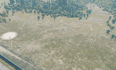

The other convenient approach to quickly scatter clusters of grass, bushes and trees across the scene is using the mesh placement brush tool:
  1. Switch to the Cluster Editor mode:
  2. Select one or several Mesh Cluster objects in the scene or create a new one by using the Create button in the Active Tool window.
  3. Paint areas with brush, scattering meshes across the scene:
  4. If needed, edit the cluster manually to reposition or remove some meshes.

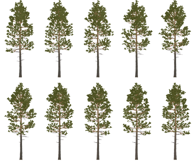

Impostors#
In terms of UNIGINE, Impostor is a billboard-like object capable of mimicking the appearance of polygon meshes by displaying different areas of textures depending on the angle of view. Impostor objects serve to speed up geometry rendering by reducing the number of polygons while saving visual fidelity.
Albedo texture for a tree impostor
The built-in Impostor Creator tool makes it easy to generate Impostors for single meshes and Mesh Clutters.
For a forest based on Mesh Clutter, the Grass object with the grass_impostor_base material will be used as a low-poly LOD. At that, the Clutter and grass parameters must match to make sure the position and orientation of all LODs are the same.
Mesh Clutter and Impostors
Meshes' and Impostors' Wireframes

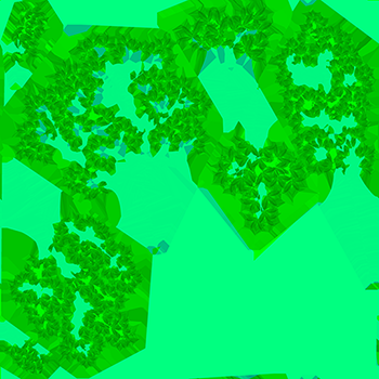

The Grass object with the grass_base material can fill empty spots on the terrain and increase the overall density of lower vegetation in the scene. The grass_base material is intended to represent the basic features of grass. It has a lower visual fidelity compared to the mesh_base material, so Grass should be thought of as an additional filling layer of grass.
First, you need to prepare a Diffuse texture with chunks representing small grass tufts:
Chunks are to be placed in the texture as follows:
  • Vertical columns represent different grass species, each of which will be distributed according to the corresponding channel of the Mask texture. Therefore, the number of columns must match the number of channels of the Mask texture; otherwise, grass tufts will be sliced incorrectly.
  • Horizontal rows represent variations of grass of the particular species (thinner, thicker, tangled, etc.). There can be from 1 to 4 rows, and this number must coincide with the Num Textures value.
For the grass texture with 4 columns, a mask with 4 channels should be used:
RGBA Image Mask for Grass of 4 Various Types
Refer to the Texture Slots section for more details.
Visually attractive grass, however, may reduce performance if rendered as a whole. All computations are time-sliced and performed per cell of a 2D grid to allow rendering at interactive frame rates. So choosing the optimal Step for cells is crucial for better performance.
For more details on creating and configuring grass, refer to the in-depth tutorial: Adding Grass.
