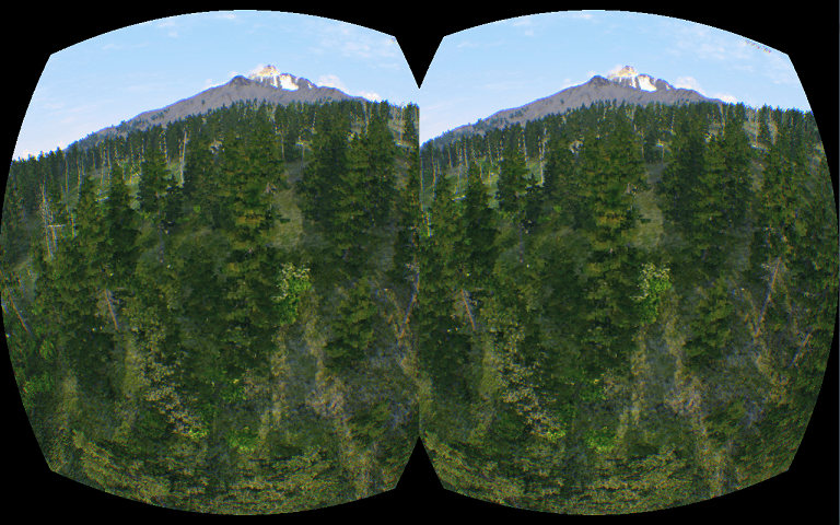

Both the windowed and the full screen modes are supported. On the PC display the image is rendered as follows:
Valley benchmark rendered on PC display with Oculus

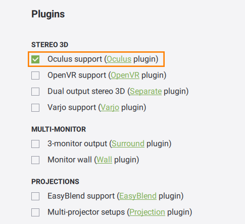

  2. Create a new project with Oculus support via UNIGINE SDK Browser: click Video Output Options, check the Oculus support (Oculus plugin) option in the form that opens and click OK.
    To add Oculus support to an existing project, in UNIGINE SDK Browser, click Other Actions -> Configure Project -> Video Output Options -> Oculus support (Oculus plugin) -> Ok.
