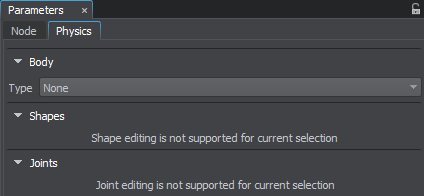

To assign and configure a body, shape, and joints, navigate to the Physics tab of the Parameters window.
It's important not to scale objects participating in physical interactions. Before assigning a physical body, ensure that the object's scale has not changed since its creation. Otherwise, all changes will be reset once the physics simulation is started.

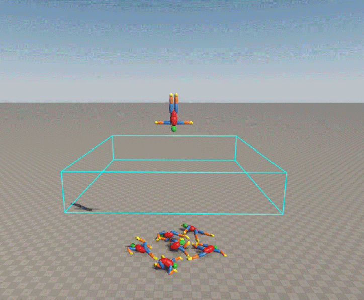

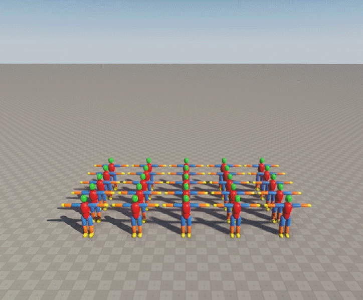

Ragdoll Body#
This type of body enables inverse kinematics and procedural animation for bone-animated characters. Essentially, this is a set of Rigid bodies, representing the character's bones connected by joints. These joints restrict the movement of the bones relative to each other, providing a realistic look.
A Ragdoll body can be assigned to Skinned Meshes only.
To assign the Ragdoll body to the object, you should create a physical Ragdoll. You can automatically generate it based on the specified parameters or create it manually by preparing a Rigid body for each bone and then saving the bones hierarchy to a *.node file.
For proper automatic Ragdoll generation, the mesh should be in the Reference Pose (T-pose for human-like characters).

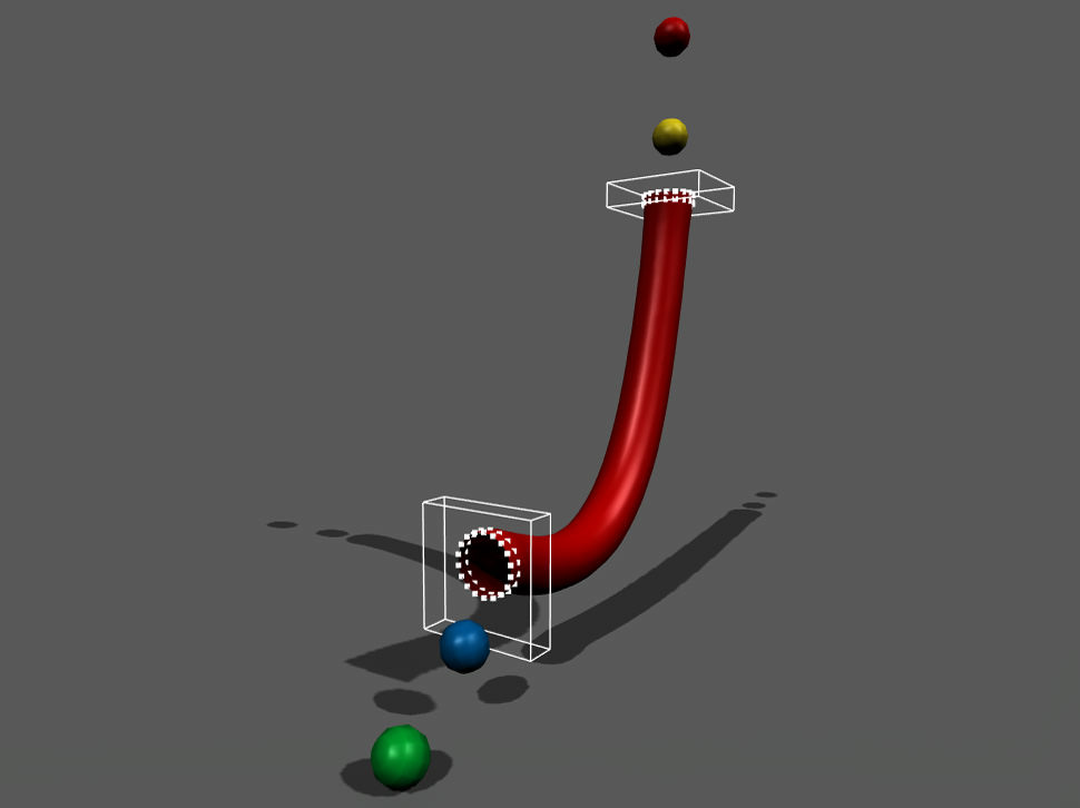

Rope Body#
It allows for the physical simulation of ropes, cables, and wires that can be torn. You can pin the ropes to the Rigid, Ragdoll, and Dummy bodies.
A Rope body can be assigned to Dynamic Meshes only. We recommend using a cylinder mesh for the Rope body (for example, it can be a standard primitive cylinder).
To attach a rope to another body, use the Particles joint.

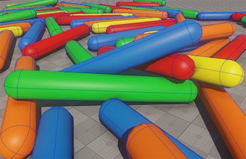

Capsule#
A capsule is another fast collision shape with continuous collision detection available. You can use capsule shapes to approximate elongated objects like pillars or even human-like characters. These shapes help the characters go up and down the stairs smoothly, without stumbling at each step, as long as the steps are not too high. Capsule shapes also ensure that the character's arms or legs do not get stuck unexpectedly.
Dynamic Meshes approximated using capsule shapes
To make the shape fit your object, you can adjust the capsule Radius and Height:

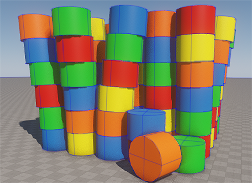

A cylinder can be used to approximate elongated shapes with flat ends (for example, shafts, or pylons).
Dynamic Meshes approximated using cylindrical shapes
To make the shape fit your object, you can adjust the cylinder Radius and Height:

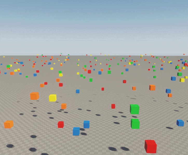

Box#
A box is a cuboid shape that can approximate the volume of various objects: walls, doors, stairs, parts of mechanisms, car bodies, and many other things. You can choose the size of a box shape in each dimension arbitrarily.
Dynamic Meshes approximated using box shapes
To make the shape fit your object, you can adjust the box size (Size X, Size Y, Size Z):
