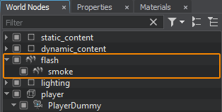

The flash is ready, now let's add some smoke. It's done as follows:
  1. Clone the first particle system and name this copy smoke.
  2. Assign the data/fps/particles/materials/gun_smoke_gray_mat.mat material to it.
  3. To synchronize several particle systems, we need to combine them into a hierarchy (the Duration value of the parent particle system must be big enough to enclose Duration and Delay intervals of all child particle systems). So, to make smoke automatically appear when flash is activated, add smoke as a child node for flash.
  4. In our case everything is simple, each of the systems generates one particle, but we need to make the smoke appear with a slight delay and last a little longer. For this, we'll set the Delay parameter in the Emission group equal to 0.1, and Life Time — to 0.2. For Increase In Radius, set the value to 0.3.
  5. The last step is to drag the flash node from World Hierarchy to Asset Browser and rename the resulting asset to gun_fire.node. Now it is ready to be used for the fire effect (the node itself can be removed from the scene).

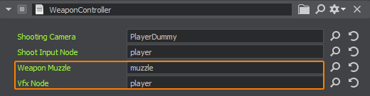

  3. Add the VFXController property to the player Dummy Object.
  4. Now add a point where the shoot effect will be visualized. Create a NodeDummy, call it muzzle, make it a child of the pistol Skinned Mesh, and place it near the end of the weapon muzzle.
  5. Select the player Dummy Object, assign the muzzle node to the Weapon Muzzle field in the WeaponController section.
  6. Assign the player Dummy Object to the Vfx Node field in the WeaponController section.
  7. Add the data/fps/bullet/bullet_hit.node asset to the Hit Prefab field of the VFXController section.
  8. Add the gun_fire.node asset that we prepared earlier to the Muzzle Flash Prefab field.
  9. Now you can press Play and test the shooting visual effects.
