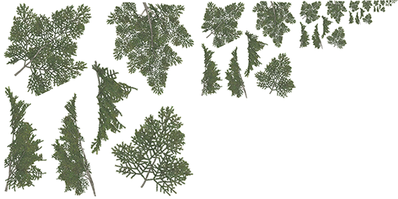

MIP Maps#
MipMapping technique, supported by UNIGINE renderer, implies sampling lower textures for smaller and distant polygons. At that, small features of foliage start wiping away with the distance, in some cases, branches and leaves look thicker when far from the camera than on a close-up view.
MIP maps
MIP maps.
This issue can be resolved via these approaches:
  • By default, MIP maps for a texture are generated automatically on import using the Box filtering that may provide too blurred results. Consider switching to the Point filtering type to get sharper MIP maps.
  • You can also prepare custom MIP maps in third-party software. For example, here is a comparison between MIP maps generated using the Box filtering and the sharper Kaiser filtering:
    To import a texture with custom MIP levels, use the Combine option for the texture with laid out MIP levels or save them to a .dds format and import the texture with the Unchanged option enabled.

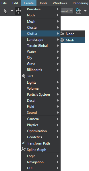

To randomly scatter a great number of identical meshes across the terrain, Mesh Clutter is used. Mesh Clutter scatters objects procedurally, and renders only those objects which are in the viewing frustum. The typical workflow is as follows:
  1. Click Create -> Clutter -> Mesh and specify the .mesh asset to be used as the source mesh for the Mesh Clutter. Click within the viewport to place the new node in the world.
    .fbx assets are containers for .mesh assets, right click on the asset and choose Open or double click on it to access its content.
