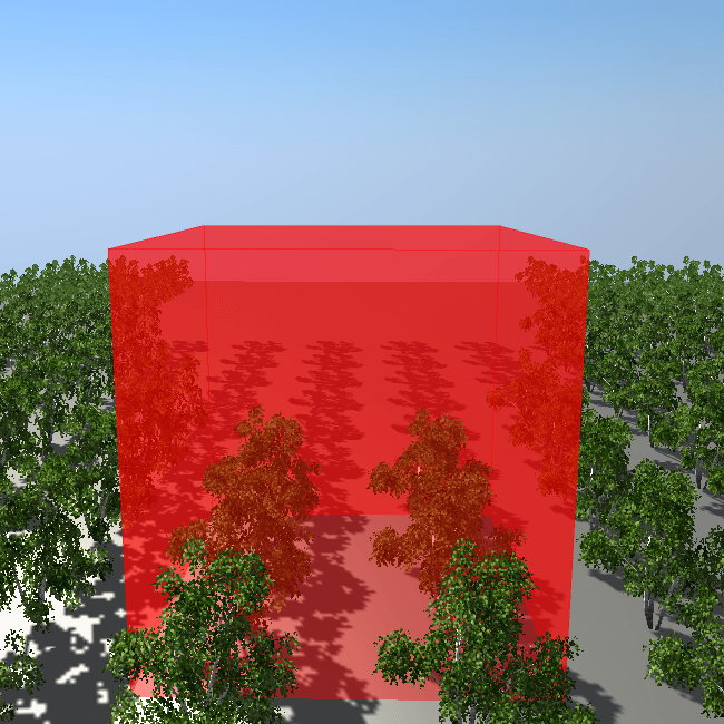

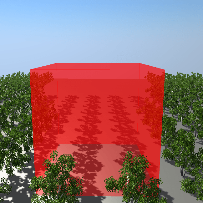

Depending on the Back face parameter value, the front or back faces of the occluder are used to cull surfaces. the front faces of the occluder include all of the occluder sides that face the camera. The back faces of the occluder include the sides that are behind the front faces.
Schematically, the occluder faces can be shown as follows:
Front faces of the occluder
Back faces of the occluder
If any part of the bound of the object's surface is visible behind the occluder, the surface will not be culled.

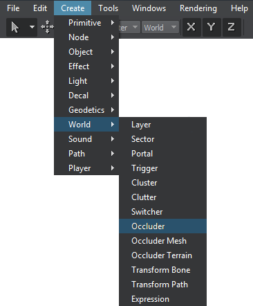

Creating Occluder
To create an occluder via UnigineEditor:
- Run the project with UnigineEditor.
- On the Menu bar, click Create -> Worlds -> Occluder.
- Place the occluder in the world and specify the required parameters for it.

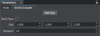

Editing Occluder
On the World Occluder tab of the Parameters window, you can adjust the following parameters of the occluder:
