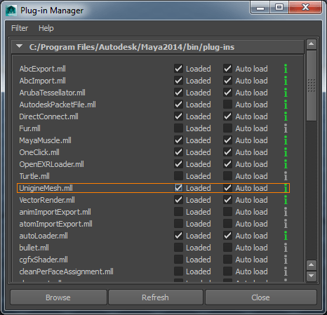

- Run Maya.
- Choose Window -> Settings/Preferences -> Plug-in manager in the Maya main menu.
- Set Loaded and Auto load flags for UnigineMesh plugins.
Loaded and Auto load flags checked for the UnigineMesh.mll

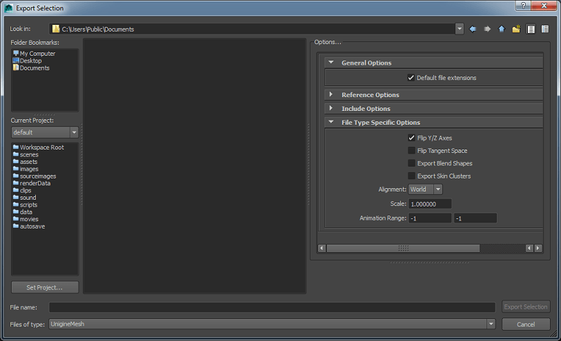

To export static geometry or an animated object into the *.mesh file:
- Select a model you want to export into Unigine.
- Select File -> Export Selection... in the main menu.
- Choose UnigineMesh in theFiles of type drop-down list.
By using the way described above, you can export animated (skinned) object baked together with its animation in one file (*.mesh). To export only the bind pose of the model, specify the 0 values in both fields of the Animation Range.
Static geometry export (into MESH format)
For skinned mesh:
- The maximum number of bones per surface is equal to 128.
- Each vertex can have up to 4 bones assigned to it.
Flip Y/Z Axes | This option flips the Y and Z axes and inverts Y axis. |
Flip Tangent Space | Flips the sign of the binormal component of the tangent space. |
Export Blend Shapes | Exports blend shapes (i.e. morph targets). |
Export Skin Clusters | Exports skin clusters (i.e. skin controllers). You should check this option to export a skinned mesh. |
Alignment | Sets a point that will be used as the origin of coordinates:
Scale | Scaling ratio. This value scales the size of a mesh. The default value of 1 means the mesh is exported without scaling. |
Animation Range | Sets the range of animation. To export only the bind pose of the model without animation, specify the 0 values in both fields. To export animation, specify the first and the last animation frame number. |

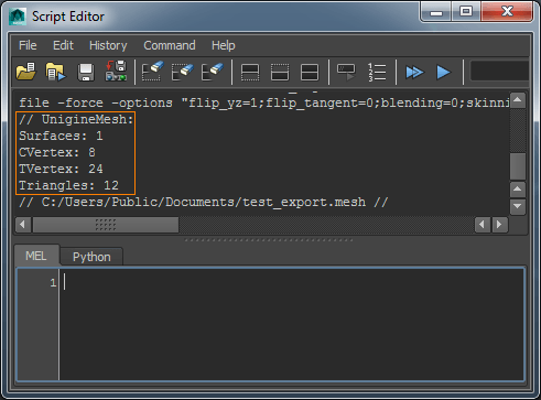

To check whether the export is done successfully, choose Window -> General Editors -> Script Editor and check the following information:
The exported surfaces and animations will be sorted alphabetically.
