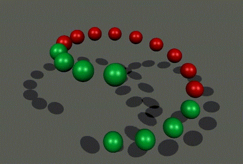

Switcher is an object that disables or enables its child nodes at a specified distance from the camera. Possible use cases are: Switcher是一个对象,该对象在距摄像机指定距离处禁用或启用其子节点。可能的用例是:
- Enabling one object and disabling another at a specified distance启用一个对象并在指定距离禁用另一个对象
- Disabling an object while moving away离开时禁用对象
- Enabling an object while approaching靠近时启用对象
Each object is composed of Switcher and two spheres of different colors每个对象都由Switcher和两个不同颜色的球体组成

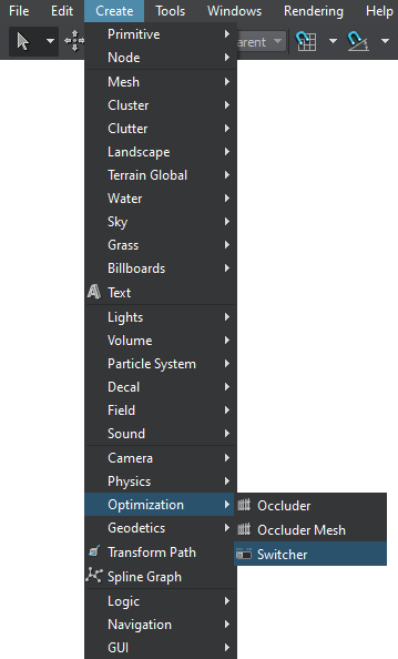

Adding a Switcher添加切换台#
To add Switcher to the scene via UnigineEditor, do the following:要通过UnigineEditor将Switcher添加到场景中,请执行以下操作:
- Run the project with UnigineEditor.跑步UnigineEditor的项目。
On the Menu bar, click Create -> Optimization -> Switcher.在菜单栏上,单击Create -> Optimization -> Switcher。
- Place the node somewhere in the world.将节点放置在世界上的某个地方。
- Make the node that will be controlled by Switcher a child of the latter.使将由Switcher控制的节点孩子后者。
- Specify the enabling and the disabling distance in the Switcher parameters.指定启用和禁用距离在Switcher参数中。

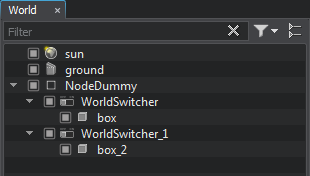

Switching between Two Objects在两个对象之间切换#
To switch between two object at the specified distance (like shown in the picture above), do the following:要在指定距离(如上图所示)之间在两个对象之间切换,请执行以下操作:
- Create a Node Dummy for convenient grouping.创建一个Node Dummy以方便分组。
- Make the first Switcher the child of the Node Dummy.使第一个Switcher孩子Node Dummy中的
- Make the first object the child of the first Switcher and specify its maximum visibility distance.使第一个对象成为孩子的第一个Switcher并指定其最大可见距离。
- Make the second Switcher the child of the Node Dummy.使第二个Switcher孩子Node Dummy中的
- Make the second object the child of the second Switcher and specify its minimum visibility distance.使第二个对象成为孩子第二个Switcher并指定其最小可见距离。

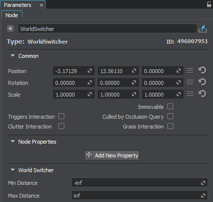

Switcher Parameters切换台参数#
In the Node tab of the Parameters window, you can adjust the following parameters of Switcher:在Parameters窗口的Node选项卡中,可以调整Switcher的以下参数:
Node tab of the WorldSwitcher nodeWorldSwitcher节点的Node选项卡
