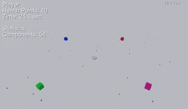

Let's make a simple game to demonstrate how the whole system works.
This case is also provided as an SDK sample.
Game Description#
In the center of the play area, we are going to have an object (Pawn) controlled by the player via the keyboard. It has certain amount of HP and movement parameters (movement and rotation speed).
Four corners of the play area are occupied by rotating objects (Spinner) that throw other small objects (Projectile) in all directions while rotating.
Each Projectile moves along a straight line in the directon it has been initially thrown by the Spinner. If a Projectile hits a Pawn, the Pawn takes damage according to the value set for the hitting Projectile (each of them has a random speed and damage value). The pawn is destroyed if the amount of HP drops below zero.
We use boxes for simplicity, but you can easily replace them with any other objects.

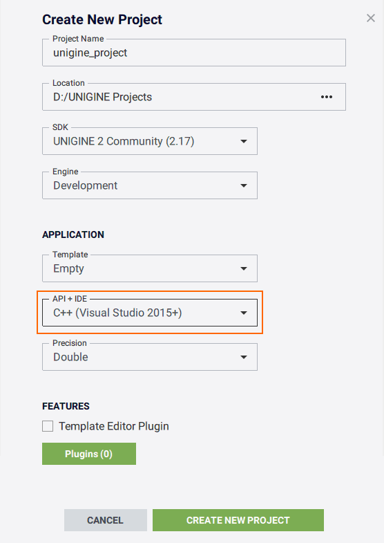

1. Prepare a Project#
Before we can start creating components and implementing our game logic, we should create a new C++ project.

Now we have all our game logic implemented in the corresponding components: Pawn, Spinner, and Projectile. There is one more thing to be done before we can start using them. We should register our components in the Component System.
All components having the REGISTER_COMPONENT macro declared in their implementation files (*.cpp), are registered automatically by the Component System upon its initialization, just add a single line to the AppSystemLogic::init() method:
int AppSystemLogic::init()
	Unigine::ComponentSystem::get()->initialize();
Voila! All our components are registered at once!

Here is the resulting code for our game including registration of components as well as adding them to nodes:
game.cpp
game.cpp
#include <UnigineEngine.h>
#include <UnigineLights.h>
#include <UnigineWidgets.h>
#include "Spinner.h"
#include "Projectile.h"
#include "Pawn.h"
// System logic class
class AppSystemLogic : public SystemLogic
	AppSystemLogic() {}
	virtual ~AppSystemLogic() {}
	virtual int init()
		// run in background
		Engine::get()->setBackgroundUpdate(Engine::BACKGROUND_UPDATE_RENDER_NON_MINIMIZED);
		// load world
		World::loadWorld("cs");
// World logic class
class AppWorldLogic : public WorldLogic
	AppWorldLogic() {}
	virtual ~AppWorldLogic() {}
	virtual int init()
		// create static camera
		player = PlayerDummy::create();
		player->setPosition(Vec3(17.0f));
		player->setDirection(vec3(-1.0f), vec3(0.0f, 0.0f, 1.0f));
		Game::setPlayer(player);
		// create light
		sun = LightWorld::create(vec4_one);
		sun->setName("Sun");
		sun->setWorldRotation(Math::quat(45.0f, 30.0f, 300.0f));
		// Note: objects are added to the world when created
		// create objects
		ObjectMeshDynamicPtr obj[4];
		obj[0] = create_box(translate(Vec3(-16.0f, 0.0f, 0.0f)), vec3(1.0f));
		obj[1] = create_box(translate(Vec3(16.0f, 0.0f, 0.0f)), vec3(1.0f));
		obj[2] = create_box(translate(Vec3(0.0f, -16.0f, 0.0f)), vec3(1.0f));
		obj[3] = create_box(translate(Vec3(0.0f, 16.0f, 0.0f)), vec3(1.0f));
		// there are two ways to create components on nodes:
		// 1) via component system
		ComponentSystem::get()->addComponent<Spinner>(obj[0]);
		ComponentSystem::get()->addComponent<Spinner>(obj[1]);
		// 2) via property
		obj[2]->addProperty("Spinner");
		obj[3]->setProperty(0, "Spinner");
		// set up spinners (set "spawn_node" variable)
		ObjectMeshDynamicPtr projectile_obj = create_box(Mat4_identity, vec3(0.15f));
		projectile_obj->setEnabled(0);
		for (int i = 0; i < 4; i++)
			ComponentSystem::get()->getComponent<Spinner>(obj[i])->spawn_node = projectile_obj;
		// create player
		ObjectMeshDynamicPtr my_pawn_object = create_box(translate(Vec3(1.0f, 1.0f, 0.0f)), vec3(1.3f, 1.3f, 0.3f));
		my_pawn = ComponentSystem::get()->addComponent<Pawn>(my_pawn_object);
		my_pawn->setDestroyCallback(MakeCallback(this, &AppWorldLogic::my_pawn_destroyed));
		time = 0;
		// create info label
		label = WidgetLabel::create(Gui::getCurrent());
		label->setPosition(10, 10);
		label->setFontSize(24);
		label->setFontOutline(1);
		Gui::getCurrent()->addChild(label, Gui::ALIGN_OVERLAP);
	virtual int update()
		// increase time while player is alive
		if (my_pawn)
			time += Game::getIFps();
		// show game info
		label->setText(String::format(
			"Player:\n"
			"Health Points: %d\n"
			"Time: %.1f sec\n"
			"\n"
			"Statisics:\n"
			"Components: %d",
			(my_pawn ? my_pawn->health.get() : 0),
			time,
			ComponentSystem::get()->getNumComponents()).get());
	Pawn* my_pawn{ nullptr };	// Pawn player
	float time = 0;
	WidgetLabelPtr label;
	PlayerDummyPtr player;
	LightWorldPtr sun;
	void my_pawn_destroyed()
		my_pawn = nullptr;
	// method creating a box
	ObjectMeshDynamicPtr create_box(const Mat4 &transform, const vec3 &size)
		mesh->addBoxSurface("box", size);
		ObjectMeshDynamicPtr object = ObjectMeshDynamic::create(1);
		object->setMesh(mesh);
		object->setWorldTransform(transform);
		return object;
// Main
int main(int argc, char **argv)
	// init engine
	Unigine::Engine::InitParameters init_params;
	init_params.window_title = "UNIGINE Engine: Component System Usage Example (C++)";
	Unigine::EnginePtr engine(init_params, argc, argv);
	// enter main loop
	AppWorldLogic world_logic;
	AppSystemLogic system_logic;
	engine->main(&system_logic, &world_logic, NULL);
	return 0;
