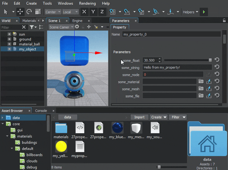

  2. Then open the UnigineEditor, select the desired node, click Add new property and drag the property file to the new property field, then drag all necessary assets and nodes to the corresponding fields of the property (see the video below).
    Linking nodes and assets to the property

  2. Then open the UnigineEditor, find the created property in the Properties window, right-click on it and select Create Child. The property named my_property_0 shall be created (you can rename it if you want).
    Create a child property
  3. Level designers make adjustments by dragging all necessary assets and nodes to the corresponding fields of the child property my_property_0, as well as by setting other parameters (if any).
