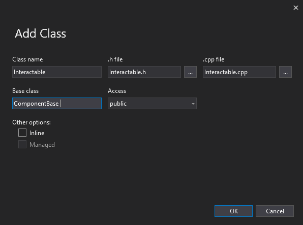

In an IDE create a new C++ class (*.h and *.cpp files) and call it Interactable. Make sure it inherits from the Unigine::ComponentBase class.
Copy the code below and paste it to the corresponding files in your project and save them in your IDE.

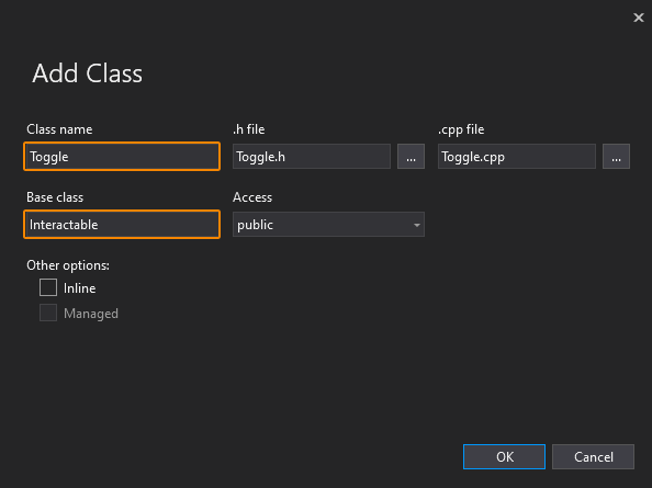

Similarly, in your IDE add a new class (Project → Add Class), call it Toggle, and type Interactable in the Base class field instead of the standard ComponentBase class.
Copy the code below, paste it to the corresponding files in your project and save them in your IDE.

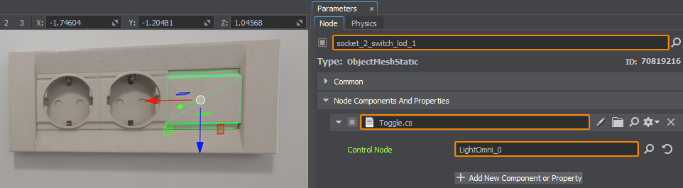

Assign the Toggle component to the socket_2_switch_lod_1 node of the left bedside switch, and drag the LightOmni_0 node into the Control Node field.

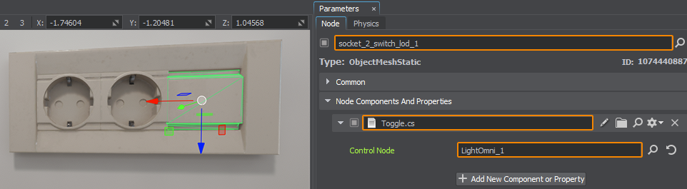

Similarly, assign the Toggle component to the socket_2_switch_lod_1 node of the right bedside switch and drag the LightOmni_1 node into the Control Node field.
