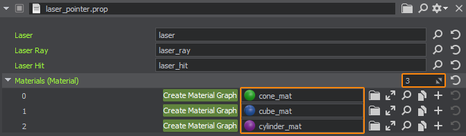

  2. Add an override of the useItAlt() method to the ObjLaserPointer component (as we are going to add a new action for the laser pointer). In the update() method, implement the logic of the useItAlt action that is executed when the corresponding flags are set.ObjLaserPointer 组件添加 useItAlt() 方法的重写(因为我们将为激光指针添加一个新动作)。在 update() 方法中,实现当对应标志被设置时执行的 useItAlt 动作的逻辑。
    Don't forget to change the value in the PROP_AUTOSAVE macro to 1 to enable updating the property created by the Component System as we're going to make changes to the component.别忘了将 PROP_AUTOSAVE 宏的值更改为 1,以启用对由组件系统创建的属性的更新(因为我们将对组件进行更改)。

    	${#HL}$// 用于切换的材质数组
    	PROP_ARRAY(Material, materials); ${HL#}$

  6. The only thing left to do is to specify the list of materials that will be applied to the object. Select the laser_pointer node and click Edit in the Parameters window. Then, find the laser_pointer property, specify the number of elements for the materials array (for example, 3), and drag the required materials from the Materials window to fill the array.现在只剩下最后一步:指定将应用于对象的材质列表。选择 laser_pointer 节点,在 参数 窗口中点击 编辑。然后找到 laser_pointer 属性,为 materials 数组指定元素数量(例如 3),并从 材质 窗口中拖动所需材质以填充数组。
  7. Save changes (Ctrl + S) and run the application via SDK Browser.保存更改(Ctrl + S),并通过 SDK Browser 运行应用程序。
