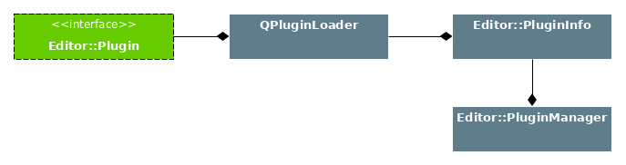

Basically the structure of the Plugin System is as follows:
Plugin System
Plugin System
Here is a brief description of the main components:
  • QPluginLoader – is responsible for plugin loading and providing meta data.
  • Editor::PluginInfo – plugin meta data parsing and storage, interaction with plugin interface, it also contains the current plugin state and information on a possible plugin initialization error.
  • Editor::PluginManager – a manager class responsible for locating plugins, building plugin loading queue, as well as loading and removing plugins.
  • Editor::Plugin - the basic class all Editor plugins inherit from, it has the following declaration:

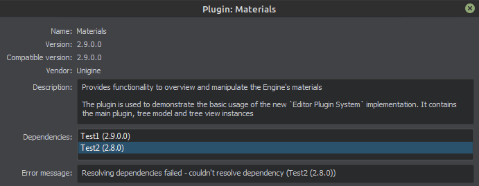

You can view any plugin's description by selecting in in the list and clicking Details.
Plugin Details
If an error has occurred when loading a plugin, a detailed message shall be displayed in the description window.
