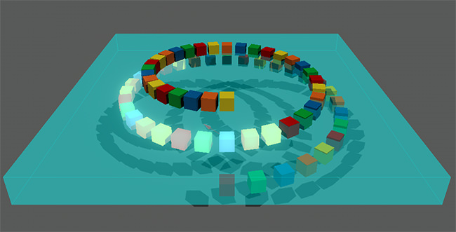

A world trigger is a cuboid shaped object, which fires callbacks when any node (collider or not) gets inside or outside of it. This trigger can be used to detect nodes and access their components and parameters.
A World Trigger Affecting Meshes

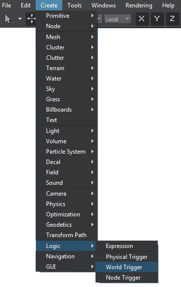

To create a world trigger via UnigineEditor:
- On the Menu bar, choose Create -> Logic -> World Trigger
Trigger Creation
- Place the node in the scene.

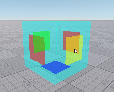

Edit Size | Toggles the editing mode for the world trigger node on and off. When enabled, the bounding box sides that can be resized are highlighted with the colored rectangles. To change the size of a side, drag the corresponding rectangle.
Touch | Toggles the touch mode for the trigger on and off. With this mode on, the trigger reacts to the node at a partial contact. Otherwise, the trigger reacts only if the whole bounding box gets inside it. |
Size | The size of the trigger's bounding box along the X, Y, and Z axes, in units. |
