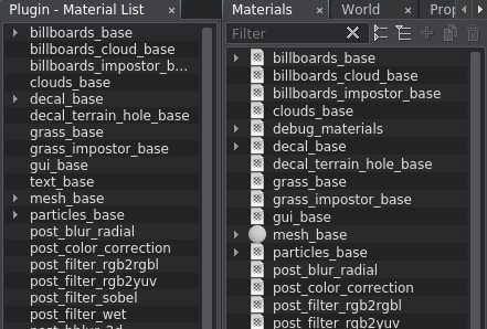

As an example we shall create a simple plugin implementing the basic functionality of the Editor's Materials Hierarchy window (see the picture below).
Materials Plugin
Materials Plugin

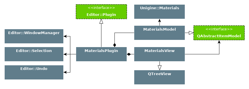

Basically the plugin's architecture looks as follows: Materials Plugin Architecture
Materials Plugin
The MaterialsPlugin class is an initialization point and complete representation of the plugin. It creates necessary data model and via the base interface associates it with the widget, which displays the hierarchy. The model directly interacts with the Materials Manager and transforms information on materials to the required structure.
The plugin interacts with all Editor's external subsystems:
  • Adds a widget to the WindowManager;
  • Adds a new item to the main menu bar;
  • Updates the state of materials widget when the global selection is changed;
  • Updates the global selection when the local selection is changed by sending a SelectionAction to the Undo stack.

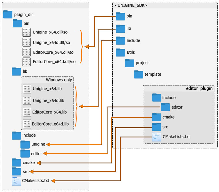

The typical structure of a plugin project should look as follows:
  • project
    • bin - Engine and Editor binaries
      • Unigine_x64.dll/so - Engine library (release).
      • Unigine_x64d.dll/so - Engine library (debug).
      • EditorCore_x64.dll/so - Editor library (release).
      • EditorCore_x64d.dll/so - Editor library (debug).
    • lib - import libraries (Windows only)
      • Unigine_x64.lib - Engine (release).
      • Unigine_x64d.lib - Engine (debug).
      • EditorCore_x64.lib - Editor (release).
      • EditorCore_x64d.lib - Editor (debug).
    • include - public API
      • unigine - Engine's public API.
      • editor - Editor's public API.
    • cmake
    • src - plugin source files
      • Plugin.h
      • Plugin.cpp
      • Plugin.json.in
      • CMakeList.txt
    • CMakeList.txt
The basic components are:
  • Engine and Editor binary files;
  • Engine and Editor public API header files;
  • Plugin source files;
  • Meta-json file;
  • Template CMake-scripts;
Using Plugin Template#
UNIGINE offers you a template to simplify creation of Editor plugins. The template can be found in the following folder: <UNIGINE_SDK>/utils/project/template/editor-plugin
First, we should create a folder for our new Editor plugin project. Then, simply copy all necessary files from the SDK installation directory to this new created folder as shown in the figure below:
If you're creating a project with double precision, the corresponding files to be copied to bin and lib folders must be with the _double suffix.
Copying Files and Folders

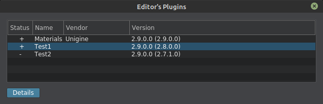

And finally we launch the UnigineEditor to check our plugin. If everything was done properly, you should see the Materials plugin in the list of loaded plugins (Help -> Plugins).
Plugins List
