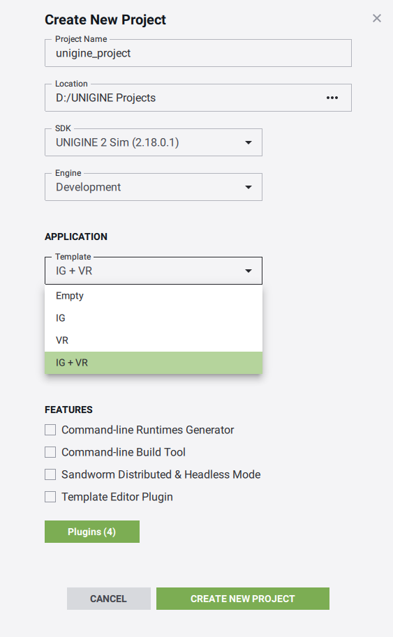

  1. Open the SDK Browser, go the the Projects tab, and create a new project using the IG + VR Template.
    Create a Project
    The newly created project will support both VR and IG features out of the box.
