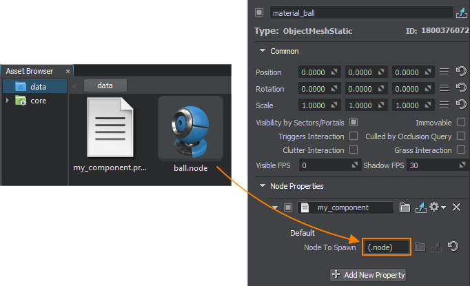

In UNIGINE, you should use World::loadNode to load a hierarchy of nodes from a .node asset. In this case the hierarchy of nodes that was saved as a NodeReference will be added to the scene. You can refer to the asset either via a component parameter or manually by providing the virtual path to it:
// MyComponent.h
PROP_PARAM(File, node_to_spawn);
// MyComponent.cpp
void MyComponent::init()
	// load a hierarchy of nodes from the asset
	NodePtr spawned = World::loadNode(node_to_spawn.get());
	spawned->setWorldPosition(node->getWorldPosition());
	NodePtr spawned_manually = World::loadNode("nodes/node_reference.node");
In case of using the approach of component parameters, you should also specify the .node asset:
