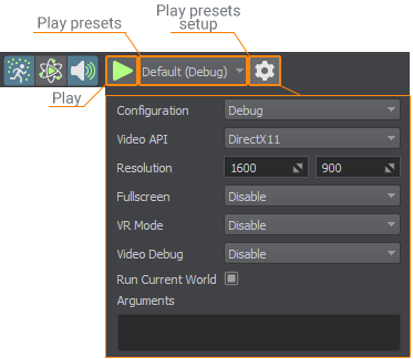

The Run button is available in the Editor to run an instance of the application in a separate window. Along with the button, there are settings available to fine-tune run options.
That's how we'll make the wheel rotate using C# Component System and run an instance to immediately check it:

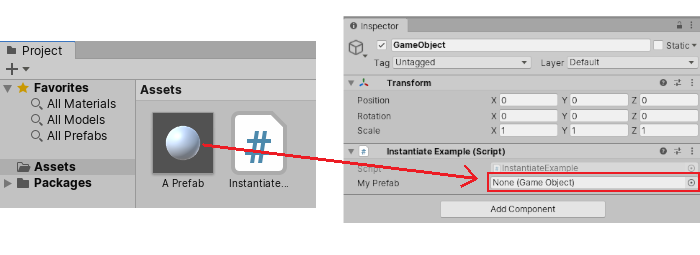

Instantiating Prefab / Node Reference#
In Unity software, you instantiate a prefab using the Object.Instantiate function:
Source code (C#)
using UnityEngine;
public class MyComponent : MonoBehaviour
public GameObject myPrefab;
void Start()
	Instantiate(myPrefab, new Vector3(0, 0, 0), Quaternion.identity);
Then, you should specify the prefab to be instantiated in the script component parameters:

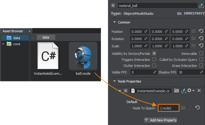

In UNIGINE, you can access any node via a component parameter as well, and clone it via Node.Clone(). However, assets are not nodes, they belong to the file system. To access assets from components use the following parameters types:
The same way you will need to specify the asset in UnigineEditor:
You can also use World.LoadNode to load a hierarchy of nodes from a .node asset manually by providing the virtual path to it:
Source code (C#)
public class MyComponent : Component
	public Node node_to_clone;
	public AssetLinkNode node_to_spawn;
	private void Init()
		Node cloned = node_to_clone.Clone();
		Node spawned = node_to_spawn.Load(node.WorldPosition, quat.IDENTITY);
		Node spawned_manually = World.LoadNode("nodes/node_reference.node");

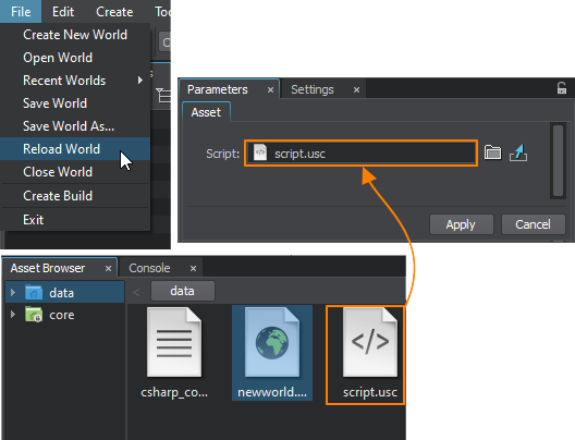

Running Scripts in the Editor#
You are likely to be accustomed that Unity software enables you to extend the Editor using C# scripts. For this purpose you can use special attributes in your scripts:
  • [ExecuteInEditMode] — to execute the script logic during Edit mode, while your application is not running.

    3. Select the current world and specify the world script for it. Click Apply and reload the world.
    4. Check the Console window for errors.
    After that the script logic will be executed in both Editor and application.
